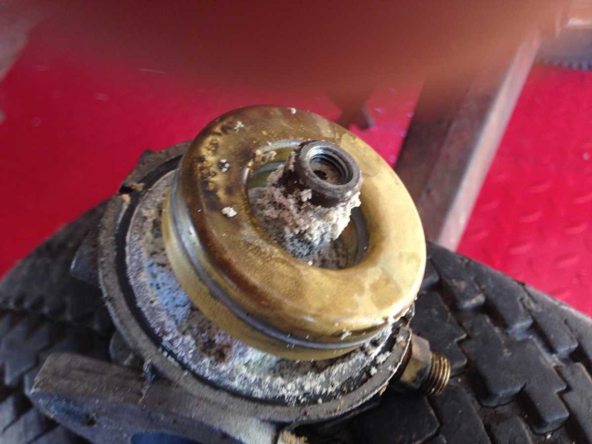

30 Jun 2015 12:32 #6375
by Bobster
Replied by Bobster on topic Carb cleaning
Well I took the carb off and soaked it in carb cleaner a couple days. Installed the new kit. Put it back on the engine and cranked it up. It was my first time to rebuild a carb and man you could tell it. I could never get it to run right. Seemed erratic. Choke it hard and it would start. Run for a while and it would quit. Played with it a couple days with no real luck.
Yesterday I took the carb off again and opened it up.......
Ugly
Could that much junk come out of the tank.
Removed tank today.
Soaking the old petcock so I can replace it.
Gonna replace fuel line
Carb is soaking in cleaner again.
How should I flush out the fuel pump? Don't want to take it apart if I don't have too.
What a mess....
Thanks for looking
Ugly
Removed tank today.
What a mess....
Thanks for looking

30 Jun 2015 12:47 - 30 Jun 2015 12:53 #6376
by JustinW.73
Replied by JustinW.73 on topic Carb cleaning
That looks pretty bad. If I were you I'd just get another carb. Fuel pumps just take it off, and hold it a little higher than the tank. Keep pushing the lever and if has comes out good then its fine.

- JustinW.73
- Small Engine Mechanic
- Posts: 348
30 Jun 2015 12:55 #6377
by JustinW.73
And that stuff is varnisized gas. Looks like water was in there too.
30 Jun 2015 14:40 #6378
Replied by Geno on topic Carb cleaning
Well, now you know what's wrong with it.
I would try to clean it out and save it, but I'm really tight. :rolling
30 Jun 2015 16:31 #6379
Replied by nappypappy on topic Carb cleaning
Don't know if you could ever clean that enough.... might be better to get a new one....unless you are as tight as Geno......:rolling2 :smile2
