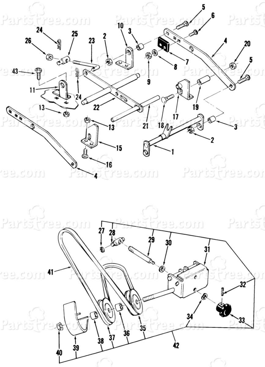

Kurt I'd take a close look at the tach-a-matic and make sure the carriage is seated properly and the hitch shaft fork (item 1) is engaged in the bar. After that check the carriage mounts and make sure they haven't shifted (items 15-17). Next check the transport stops (19) on each side and raise them up, this might be part of the problem if they are set too low.

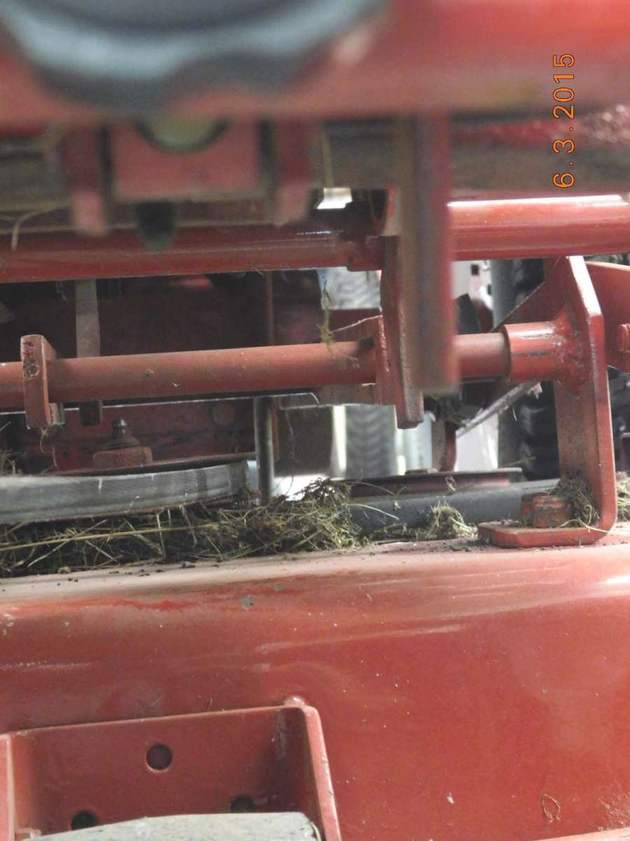

03 Jun 2015 11:00 #5232 by Kurt-NEPA
Replied by Kurt-NEPA on topic Lift bar hitting the center spindle on 48" deck.
M Bailey wrote: Kurt I'd take a close look at the tach-a-matic and make sure the carriage is seated properly and the hitch shaft fork (item 1) is engaged in the bar. After that check the carriage mounts and make sure they haven't shifted (items 15-17). Next check the transport stops (19) on each side and raise them up, this might be part of the problem if they are set too low.

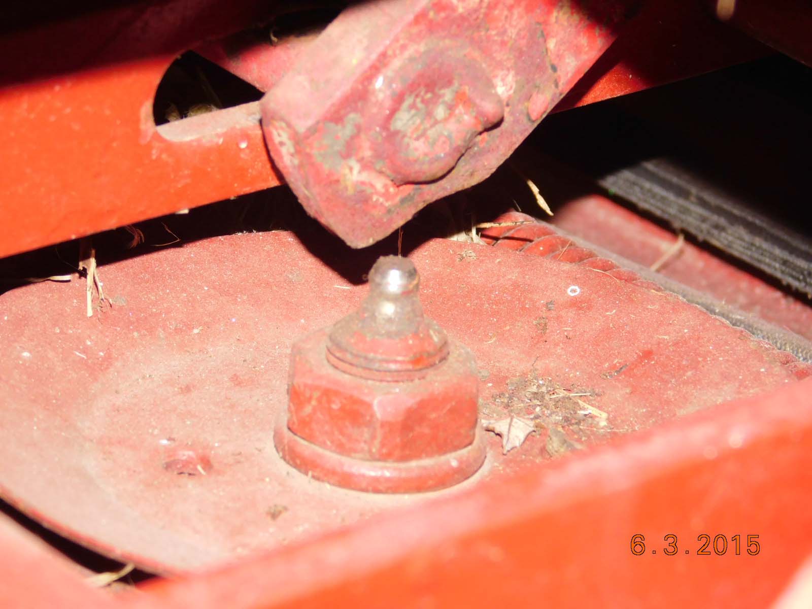

Well, I pulled the deck and checked things out.
Here is the problem
[IMG
1. The spindle shaft is toast - the grease zerk went off sideways and wallered out the threaded hole. I think I could fix it, but the spindle is just not that expensive, so I'll order one..
2. The carriage was seated in the tach-a-matic as it should be. Nice and tight
3. The carriage mounts (15-17) are tight and where they belong.
4. The transport locks were in the full down position (or is that full up). The bolts were all the way down.
My plan - raise the transport lock bolts to the top. Grind a bit off the bottom of the lift bar. We'll see what happens. I'll order a new spindle and replace that later.
03 Jun 2015 11:57 #5233 by Geno

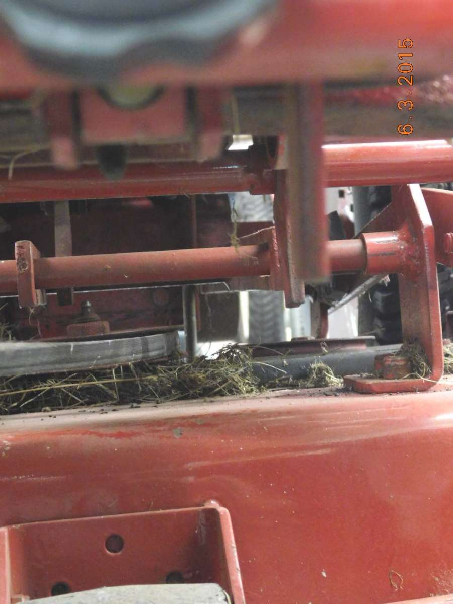

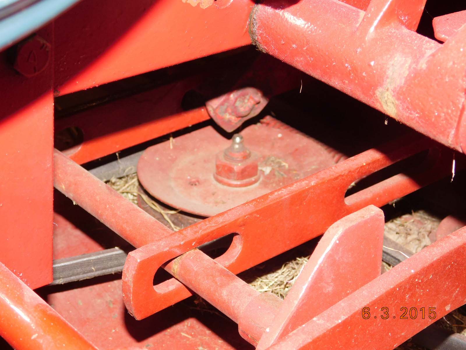

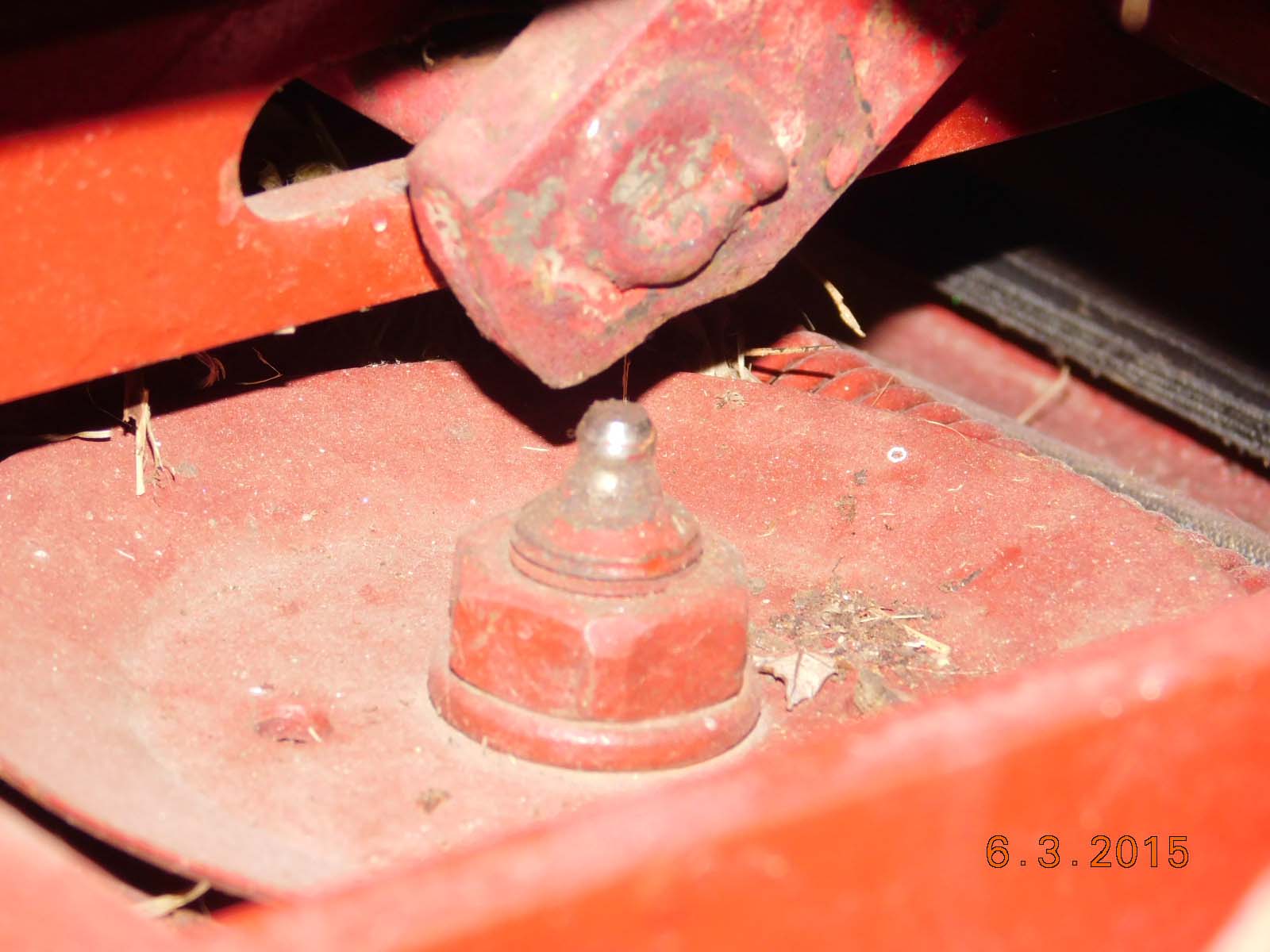

The arm should be a little to the right, putting the grease fitting to the left of the bar. It will still be really close. For what you are trying to fix, the deck needs to go toward the left or the arm needs to go toward the right.
The carriage stops will only affect the raised height of the rear wheels when the deck is raised, they should always be adjusted all the way up, in almost every case that is still not enough.
Here are some pics of one in the shop.
03 Jun 2015 12:08 #5236 by Kurt-NEPA
Wow Geno!, thanks for the pictures. I think you nailed it. My rod is almost centered on the spindle. I tried to move it to the right and it won't budge more than about 1/8".
I just ground the end of the lift bar down about 1/8" and now it clearing the spindle, but not by much. Maybe 1/16" At least I've got a mower.
I replaced that lift bar several years ago. When I bought the tractor it was broken. I wonder if I got the wrong one, or if I got it installed wrong. As I remember (and that's tough on this old bald and gray head) that rod can only go in one way. Looks like I have more work to do.
