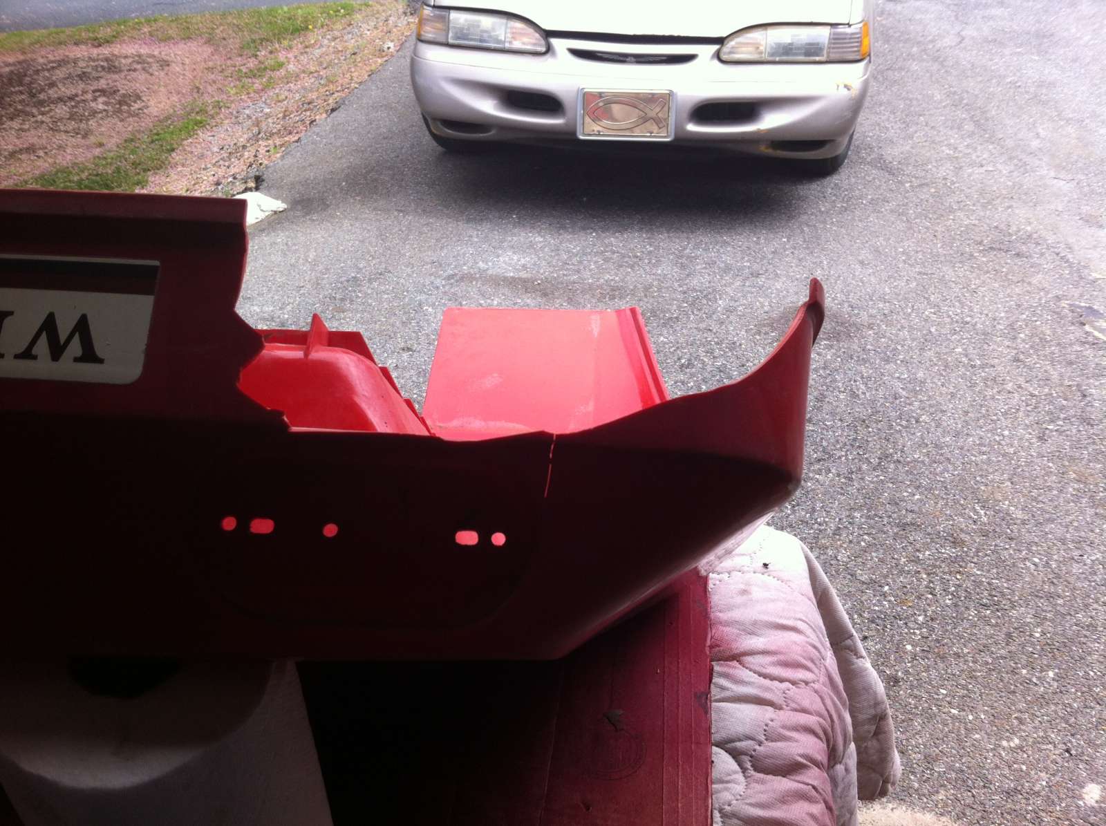

14 May 2015 05:24 #4478
Replied by GT 14 on topic Plastic fender repair
I have a sheet of 1/8 ABS and I am fabricating a patch. I think my trusty JB Weld will handle the job.
14 May 2015 05:36 #4480
Replied by M Bailey on topic Plastic fender repair
I have no doubt it'll come out looking good.
14 May 2015 07:51 #4485
Replied by Geno on topic Plastic fender repair
:agree Major, GT doesn't mess around.

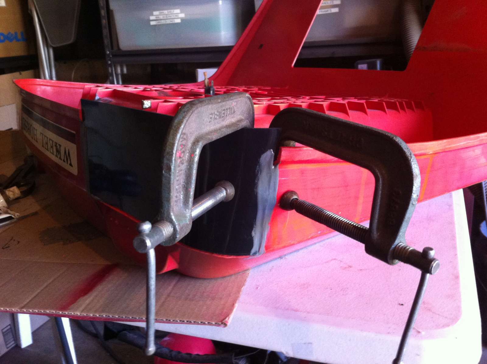

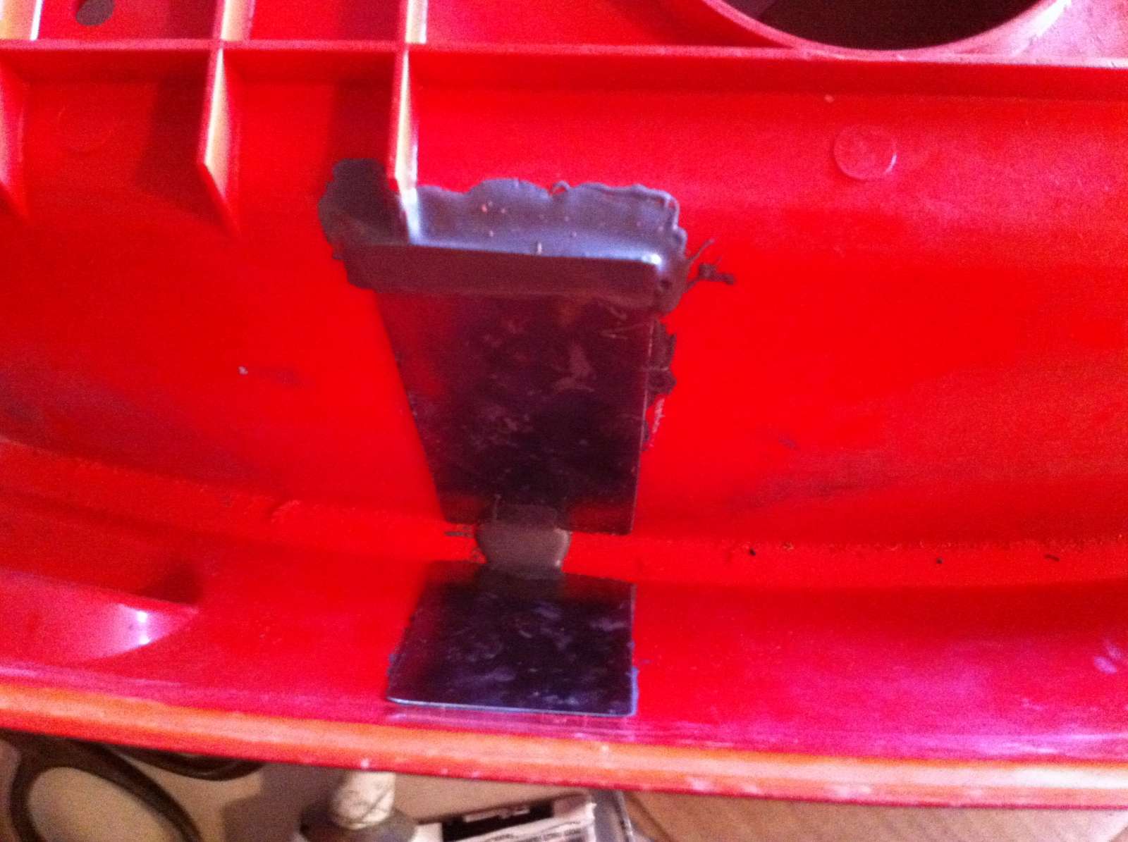

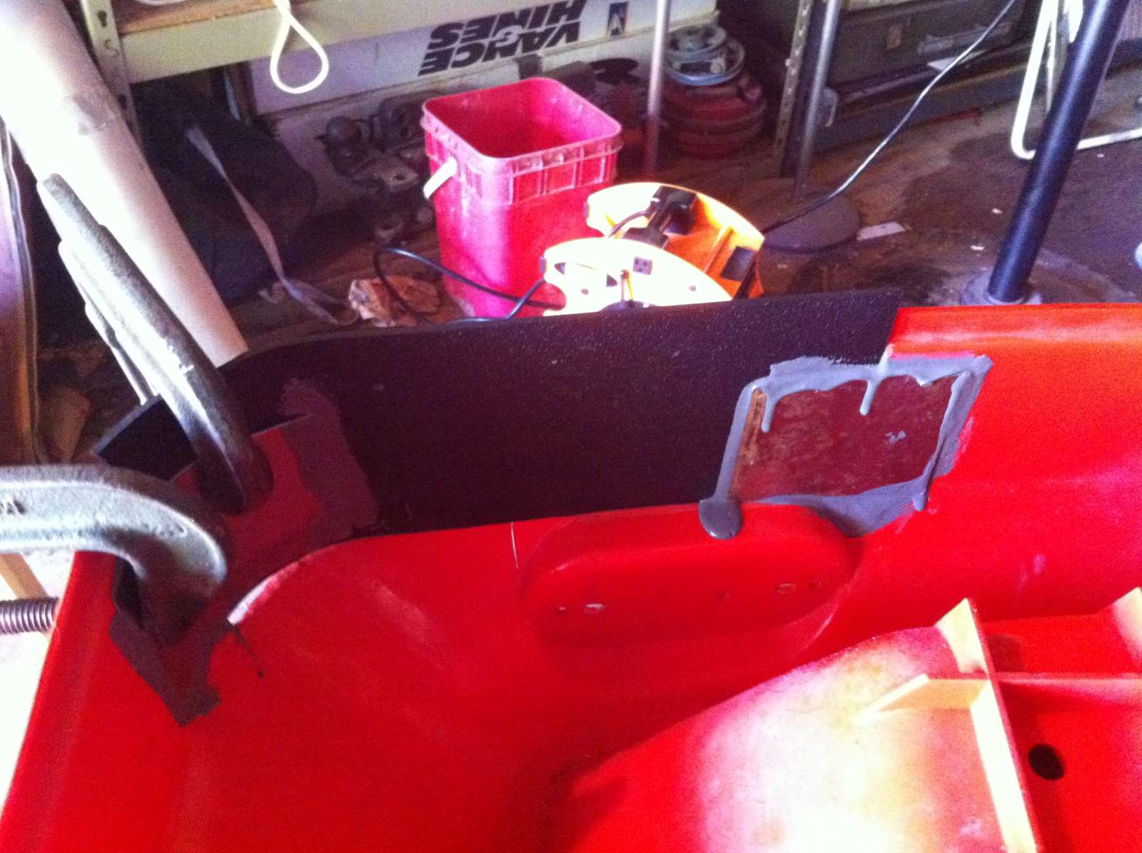

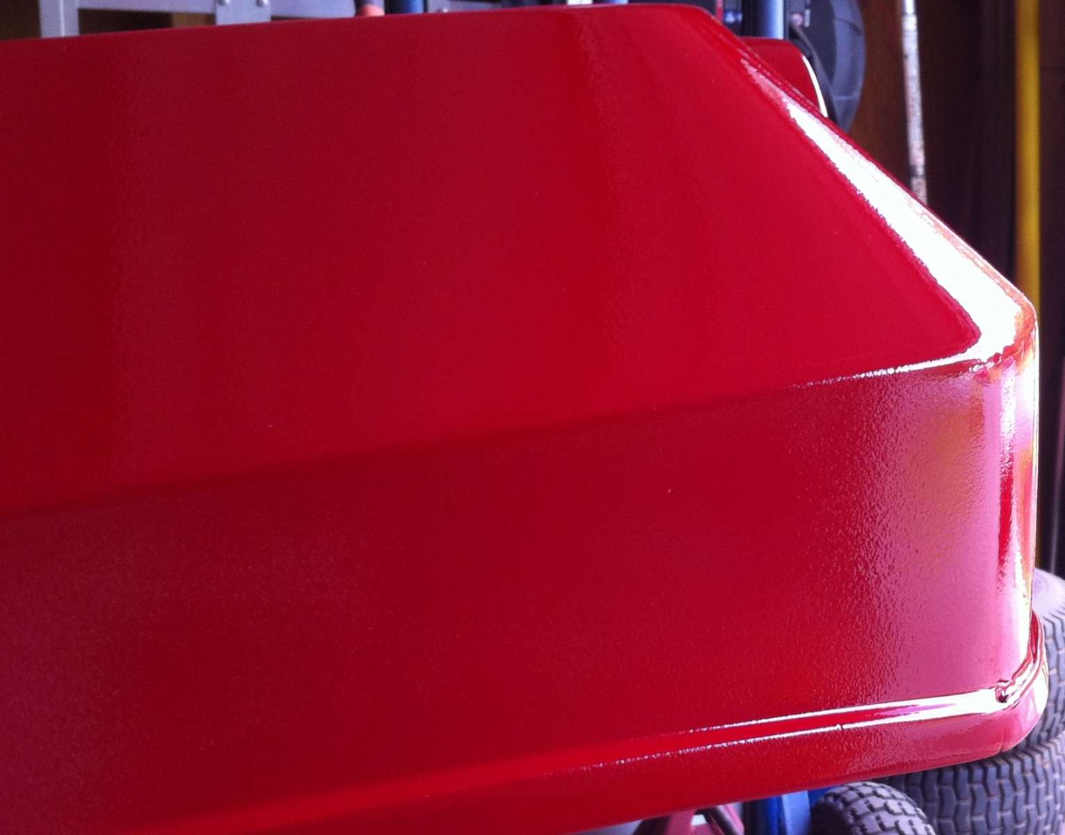

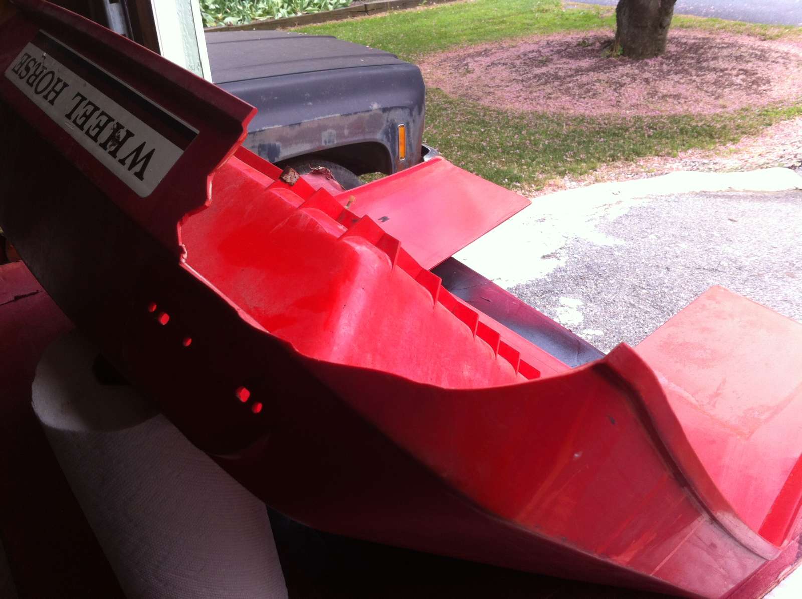

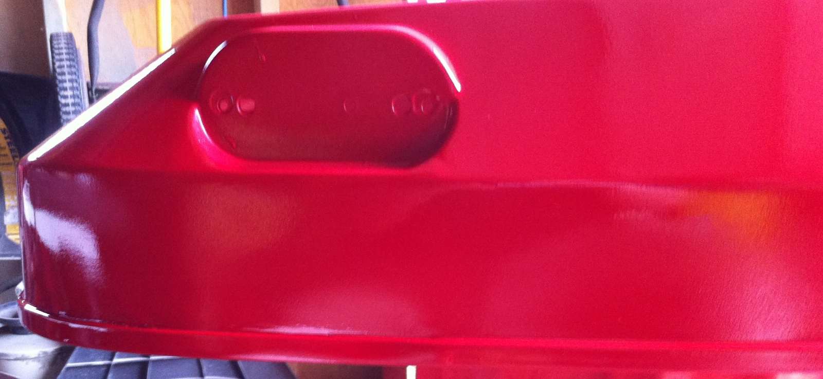

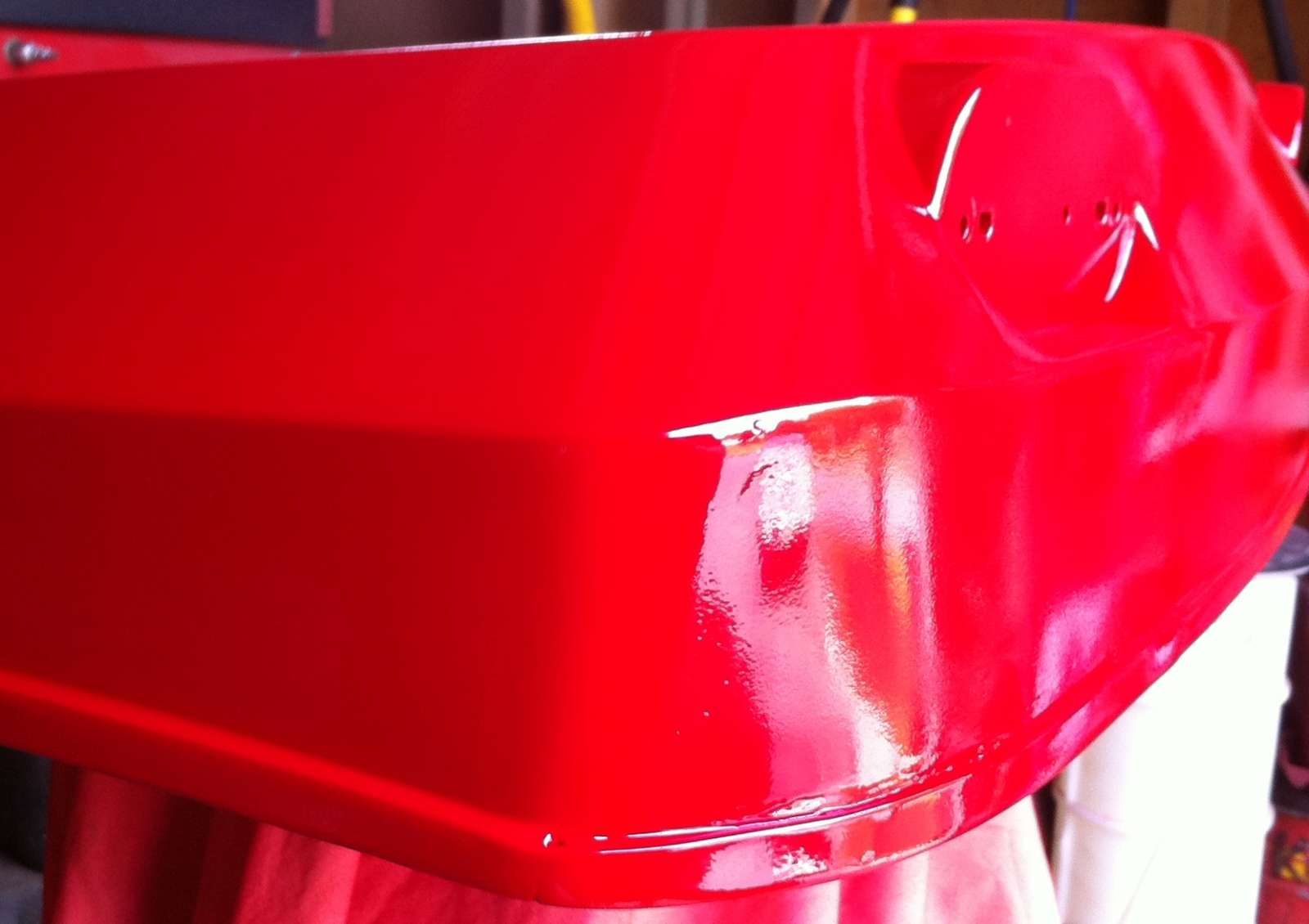

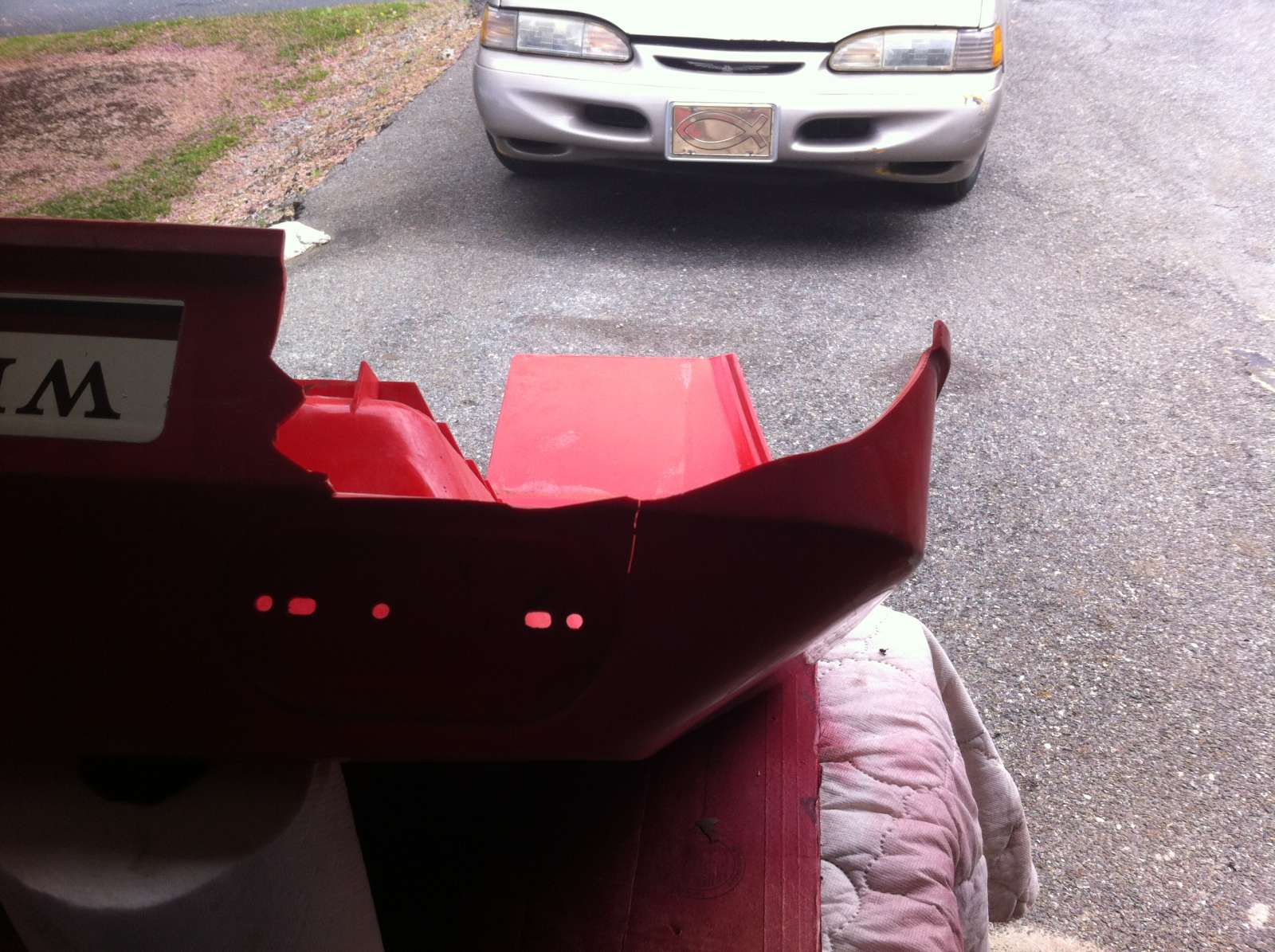

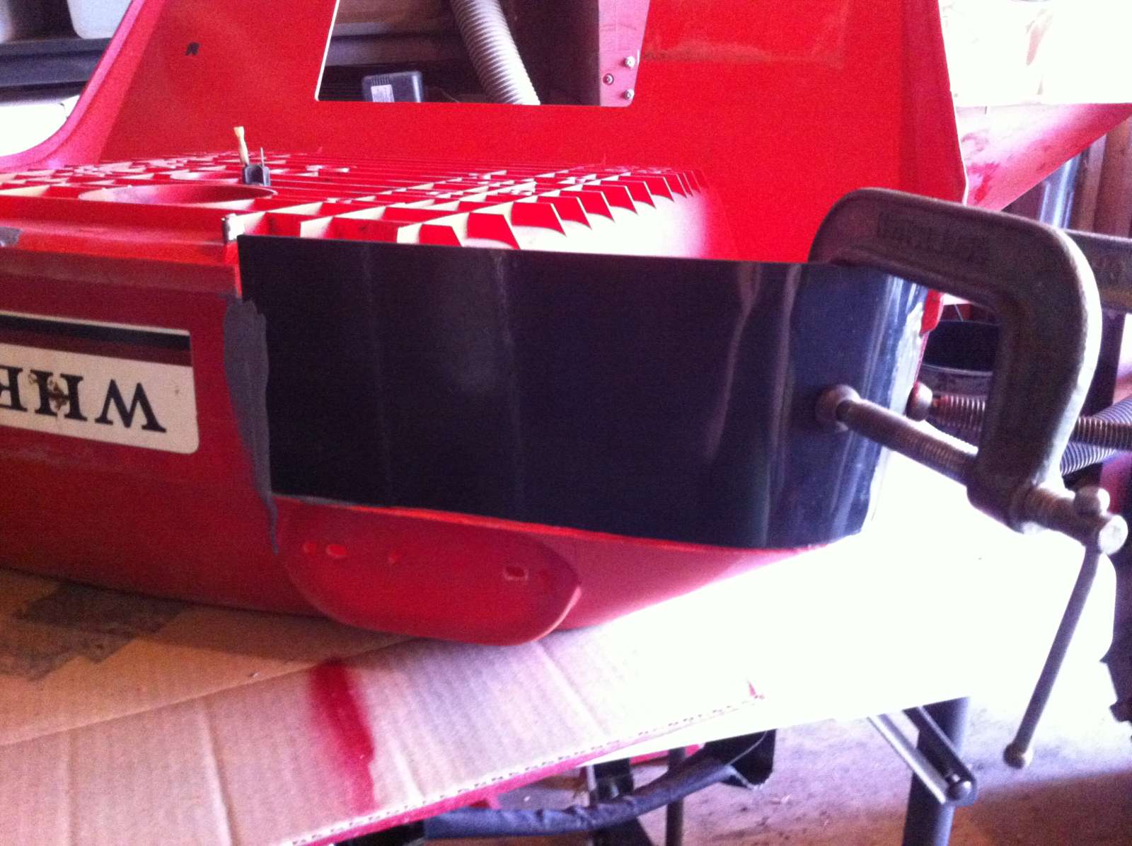

14 May 2015 19:54 - 26 May 2015 16:04 #4499
Here we go
Squared up the area, and cut and shaped 1/8" ABS. Used heat gun to get the curve.
Decided that strength was needed so I am using small squares of sheet metal.
Covered the entire piece of metal with JB and clamped.
Also repaired a large crack down the middle with same process.
Finally the new fender has emerged!
Last edit: 26 May 2015 16:04 by GT 14.
The following user(s) said Thank You: GlenPettit, 23 AUTOMATIC LSE
14 May 2015 20:10 #4500
Replied by nappypappy on topic Plastic fender repair
:cool looking good.
