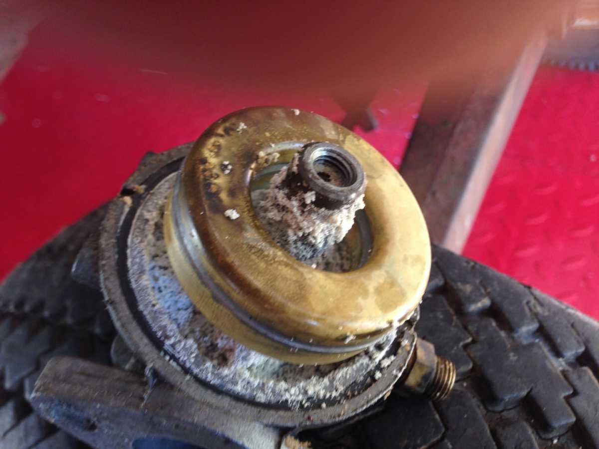

Well I took the carb off and soaked it in carb cleaner a couple days. Installed the new kit. Put it back on the engine and cranked it up. It was my first time to rebuild a carb and man you could tell it. I could never get it to run right. Seemed erratic. Choke it hard and it would start. Run for a while and it would quit. Played with it a couple days with no real luck.
Yesterday I took the carb off again and opened it up.......
Ugly
Could that much junk come out of the tank.
Removed tank today.
Soaking the old petcock so I can replace it.
Gonna replace fuel line
Carb is soaking in cleaner again.
How should I flush out the fuel pump? Don't want to take it apart if I don't have too.
What a mess....
Thanks for looking

That looks pretty bad. If I were you I'd just get another carb. Fuel pumps just take it off, and hold it a little higher than the tank. Keep pushing the lever and if has comes out good then its fine.

And that stuff is varnisized gas. Looks like water was in there too.

Well, now you know what's wrong with it.
I would try to clean it out and save it, but I'm really tight. :rolling
- Posts: 2013
30 Jun 2015 16:31 #6379
Replied by nappypappy on topic Carb cleaning
Don't know if you could ever clean that enough.... might be better to get a new one....unless you are as tight as Geno......:rolling2 :smile2
