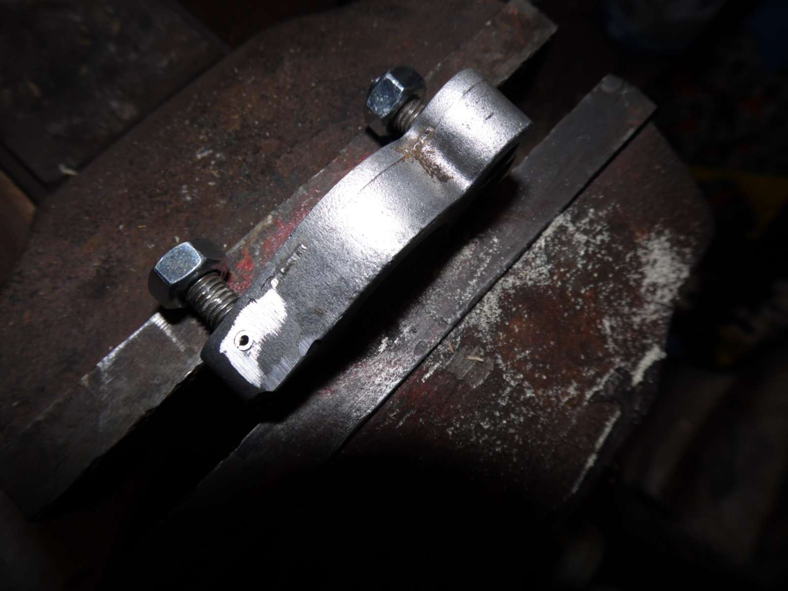

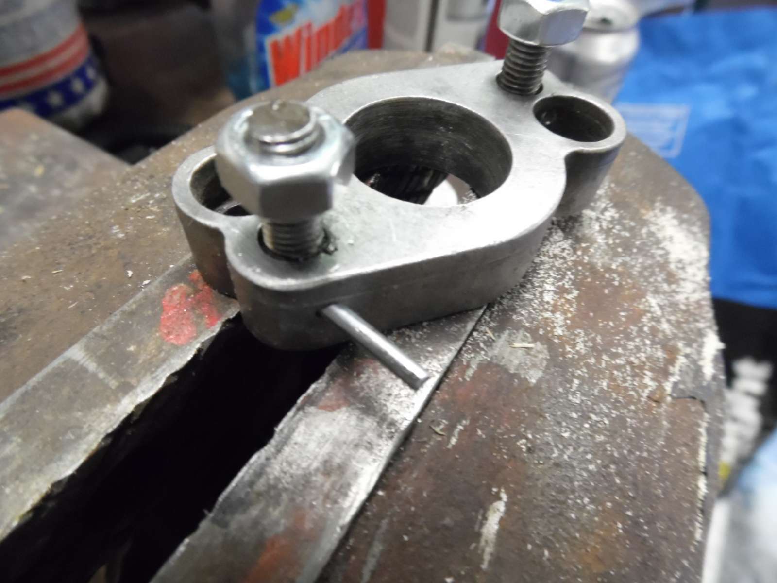

These H60 carb adapters can be a real pain when trying to remove the carburetor by itself. Why they designed these this way is still a mystery to me! The 1/4-28 bolts are free to turn when removing the carb so here's the fix.
Drill and pin the bolts as shown.
Cut off the excess roll pin
Grind level the roll pins and now we have 2 fixed studs on the carb adapter!
Last edit: 22 May 2015 15:56 by M Bailey.
The following user(s) said Thank You: Geno, GT 14

nice work....I learn something almost everyday.... :goodjob

Thanks Pappy, you would have thought they would have molded the studs into the adapter but sadly that was not the case.

Nice job, I like solutions when issues like this arise.

Nice Major. The best fix is one that can still be taken apart. :goodjob

Simple and it works.....Like!!!!
