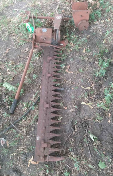

Hey guys. This popped up for sale near me with some other attachments and a tractor. what does it go on? He is selling a gt1600 but this is obviously a lot older.

Does it have a model # on it?

Not sure on the model number. Tag isn't readable.

I have a few of those 42" + 50" but never put one on a tractor. I'm afraid I won't be much help on this one...
I do know there is a lot to putting one on and setting them up by the looks of them. All of the tractors on the owners + parts manuals show them on 1969 and older tractors. They also show removing the PTO clutch if it has one, and there is a special pulley you have to put on the engine for them regardless if there is a PTO clutch or not.
