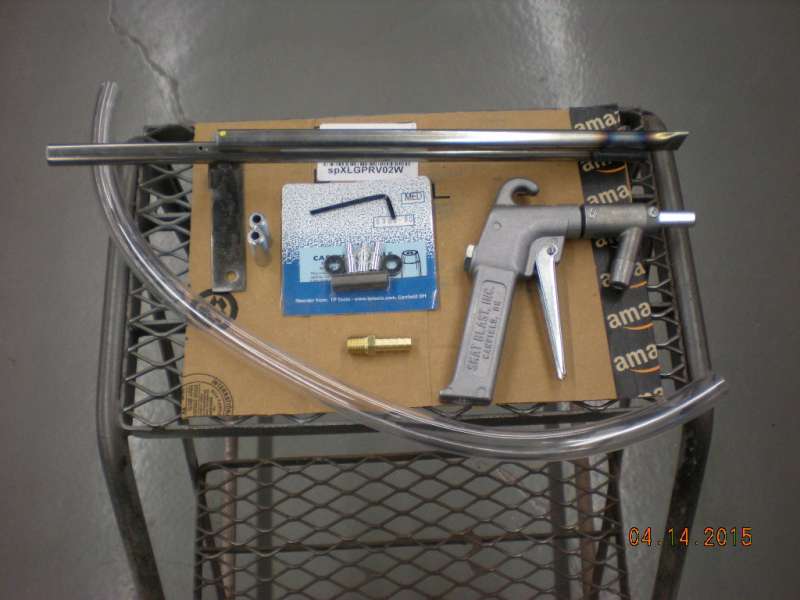

We've had the old HF sandblaster for 20 years but it's time to update it. There's a new gun kit with suction tube and carbide tip supposed to be here this afternoon. We're gonna turn it Made in USA.
Nick has already done this to his and said it made a huge difference. The Carbide tip will outlast 30 ceramics making it way cheaper in the long run. Will put up pics of the actual stuff when it arrives.
Gun + pickup upgrade kit is here - Gun Kit
Tip is here - Carbide Tip

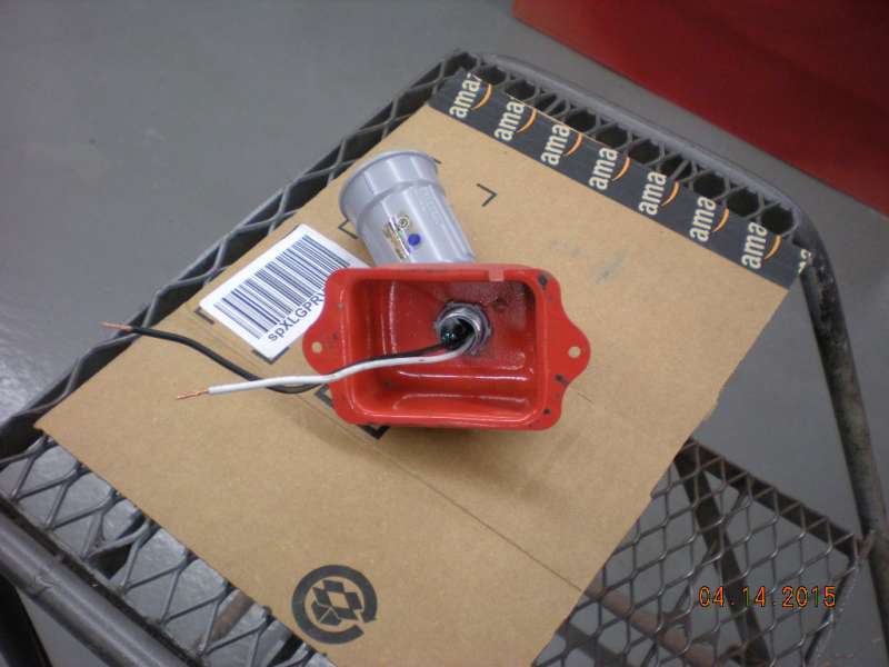

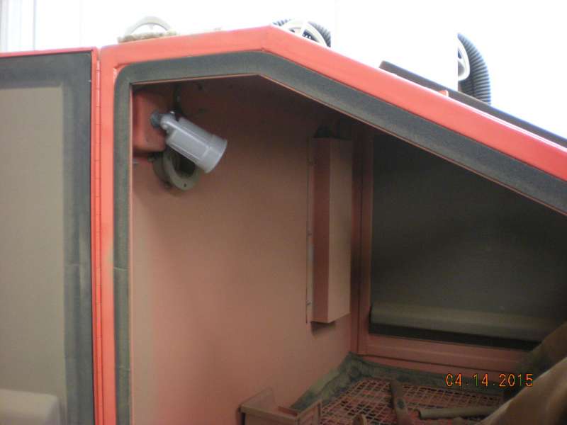

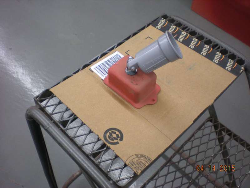

We also just got finished with a $4 light upgrade from the local hardware store. The best thing we ever did.

Sandra has been blasting like the wind. The light is awesome with just a little 13 watt twisty in there and then new gun is awesome. It is way faster, maybe 4-5 times faster. Pretty much as fast as you can go.

The new gun has a smooth action and little resistance to the trigger. It will spray at higher pressures also. At over 80lbs the HF gun wouldn't even come on. The gun also seems to use less air for some reason, the compressor actually shuts off if you stop to grab the next part in the cabinet. I don't know what they've done but they've done it very well. Maybe it has something to do with the made in USA thing also.
