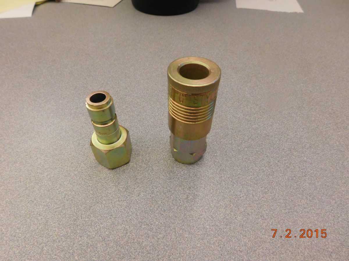

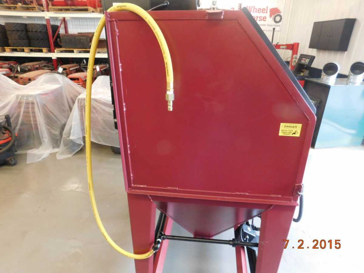

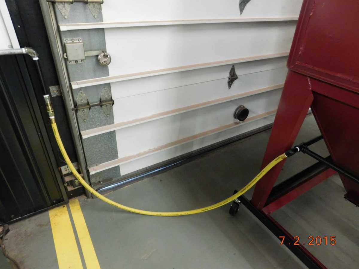

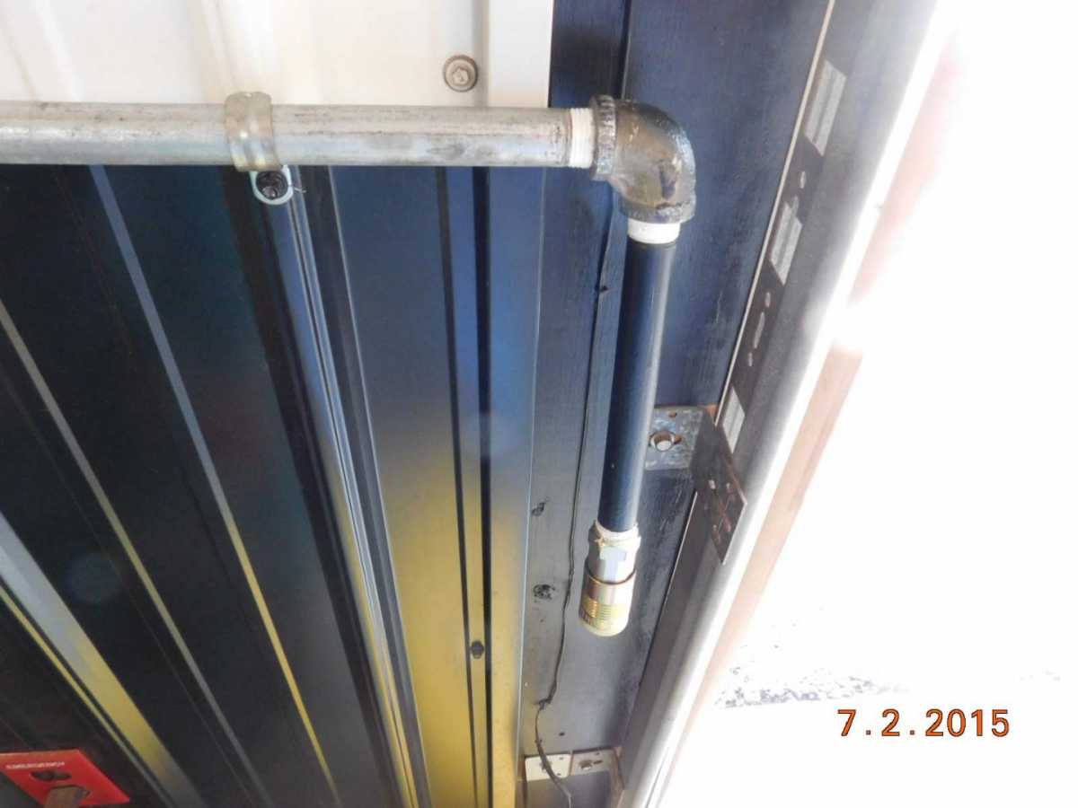

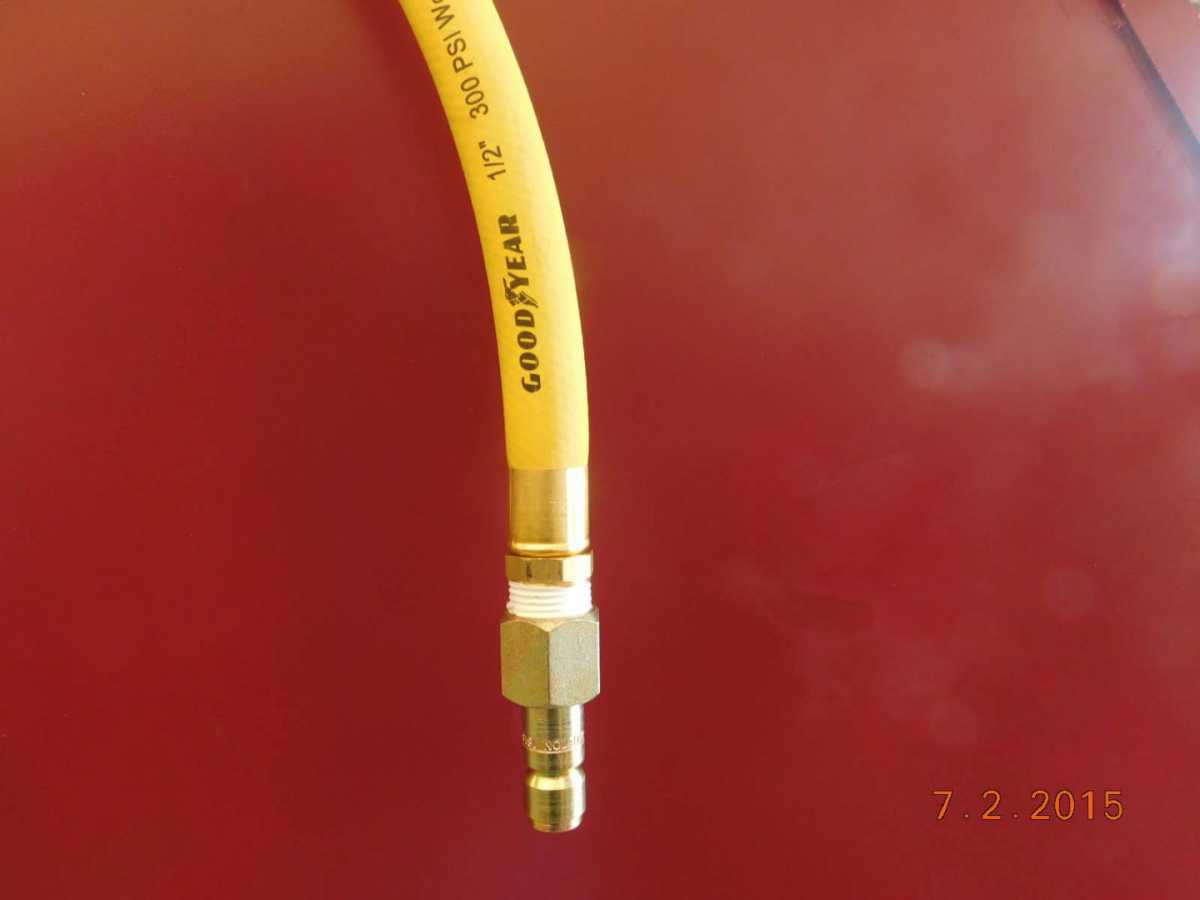

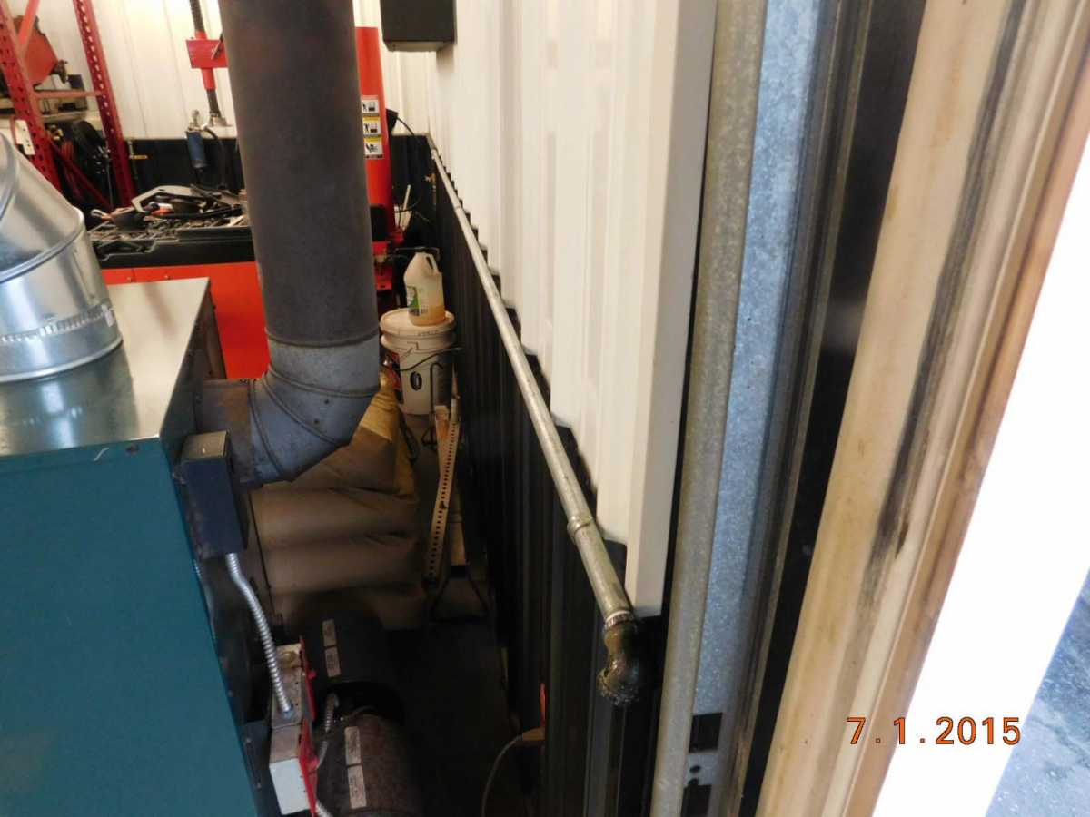

It's almost ready to try out.
Almost forgot last night that we had to tap in and make a long run to the door where it will be used most of the time. The 1/2" couplers and hose came in this morning.
