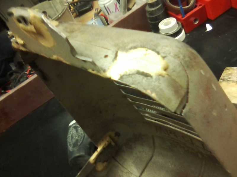

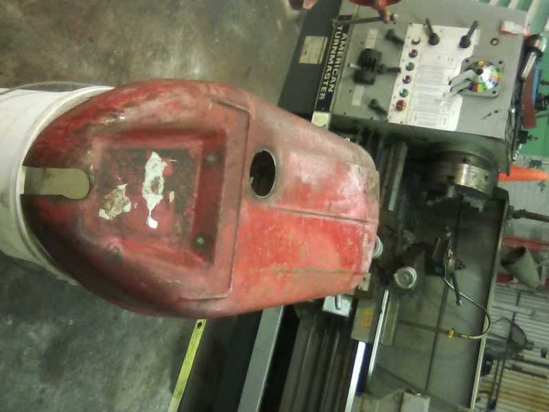

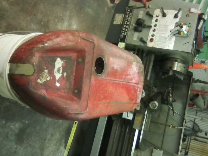

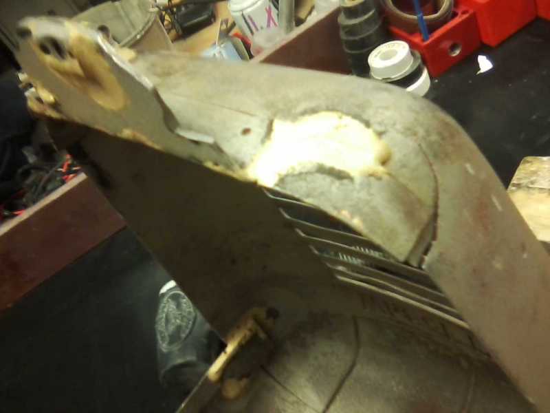

Here is the hood before it blasting and after,
the bad part is what you find under the paint, now how did this happen?
we all been there and we all done it so, its not like its a elite club i am joining.
just paying my dues for joining.
Thinking about what i want to do to correct the cracking in the brazed areas.

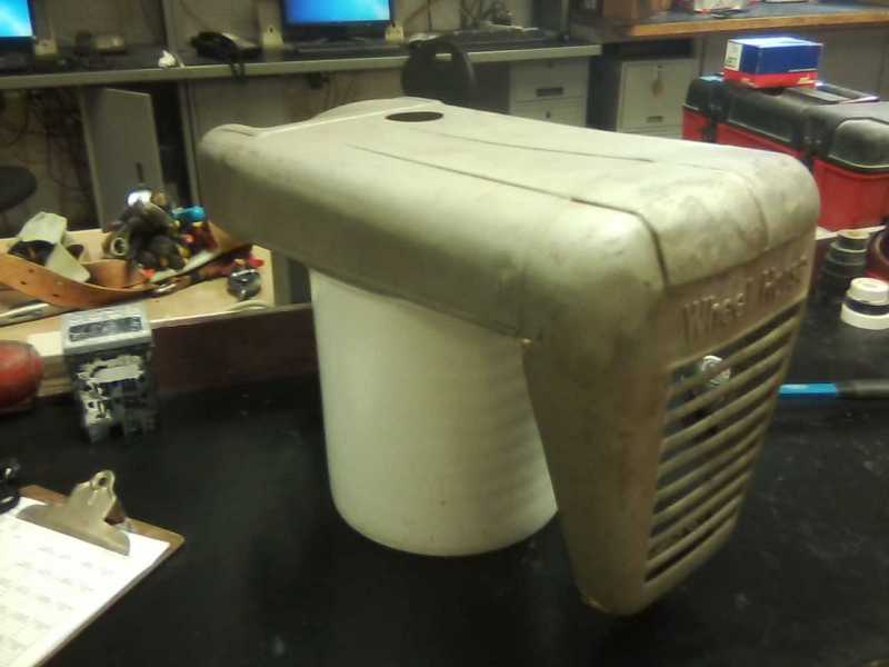

09 Mar 2015 23:05 #613

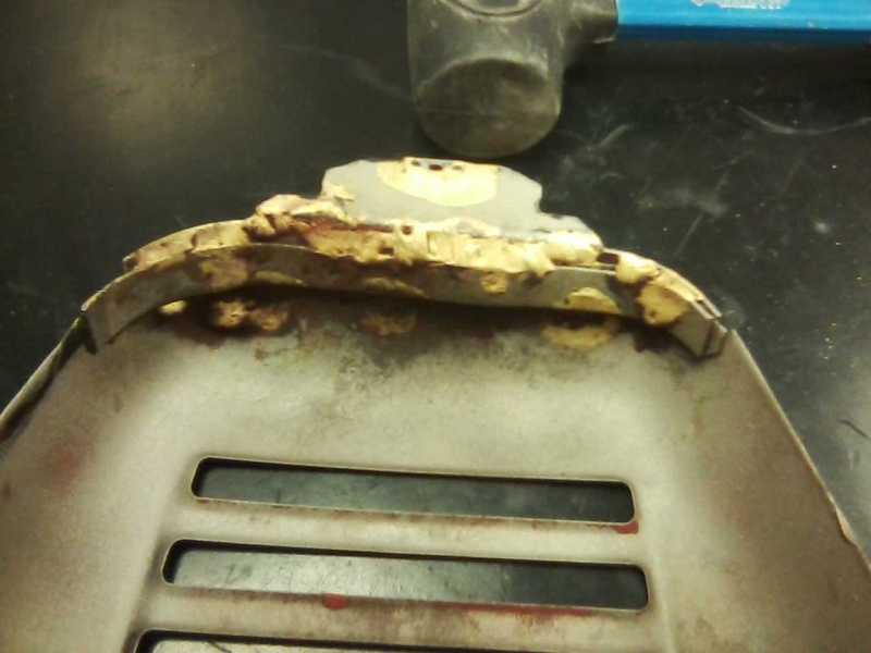

After some clean up of someone's brazing technique and some added strapping. and a return trip to the blaster for touch ups.
its under primer, awaiting filler and wet sanding.
by the time we are done with the build.
Geno should be able to get RUSTOLEUM as a paid sponsor
i will be using RUSTOLEUM primers and paints.
and a lot of 3M wet sanding cloth.

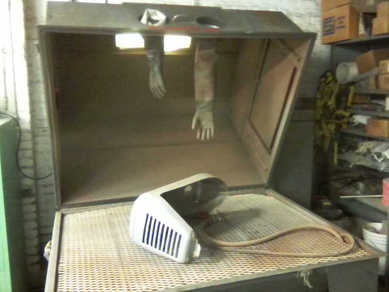

09 Mar 2015 23:20 - 09 Mar 2015 23:24 #615

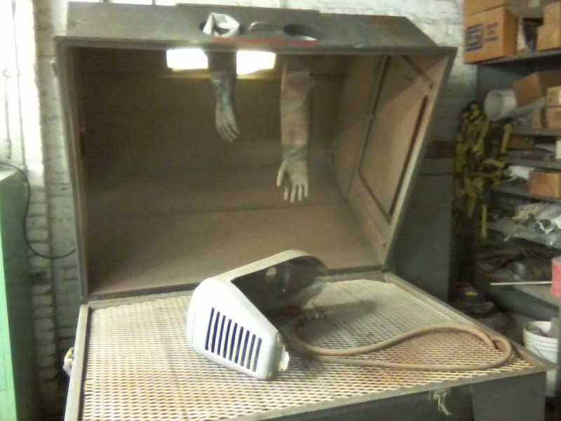

here it is
ok
ok
Last edit: 09 Mar 2015 23:24 by jm46322.
10 Mar 2015 04:26 #625
That is a big blasting cabinet....looks like you could set the whole tractor in it.....lol....
I like the rustoleum vendor idea......

It's nice to have a sand blasting cabinet, I have to farm my stuff out. It costs me about $75 bucks to get everything i need done. If I had the room I would have one. I to am a big Rust-oleum user, they should send us some discount coupons.
13 Mar 2015 18:50 #838
There are a lot of people who build their own sandblaster out of plywood. I've thought of doing this myself, the can be made big, and to look very nice.

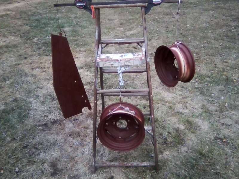

15 Mar 2015 22:47 #1113
i made my parts into a wind chime today......
well it kind of looks like one

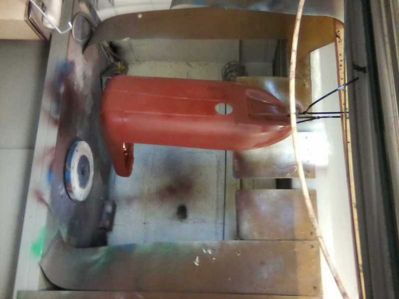

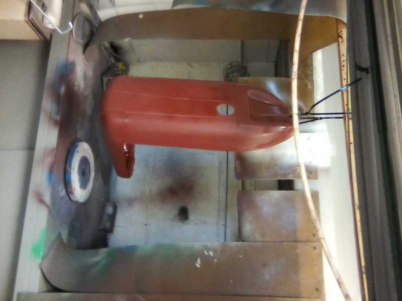

just moved out side in the nice weather to do some priming .
this color of red primer is getting old
but so is wet sanding in 50 deg weather
