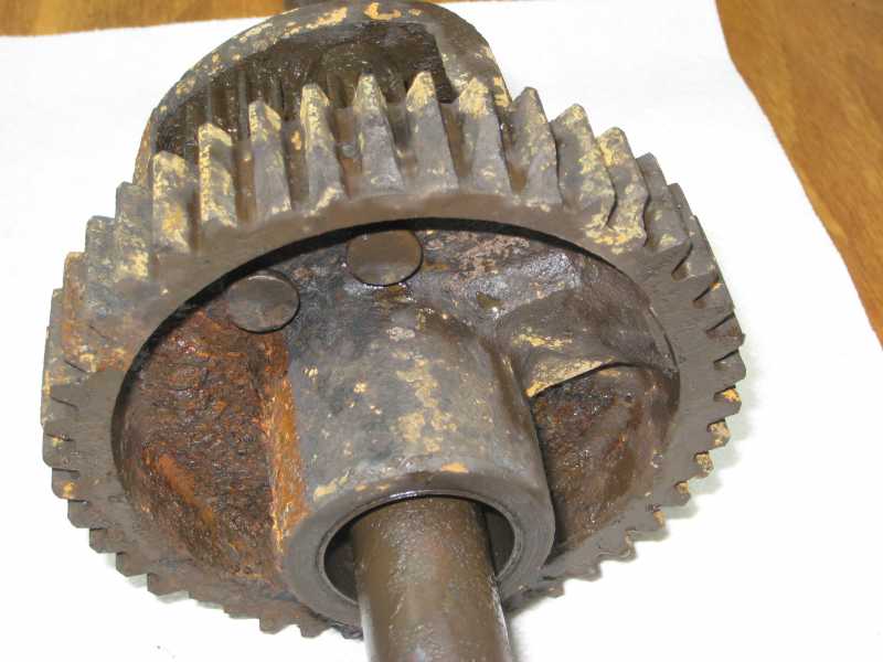

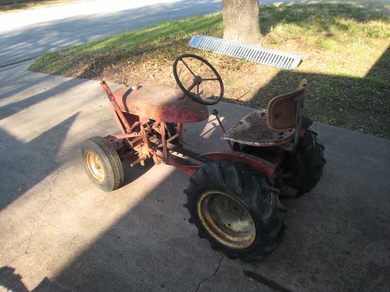

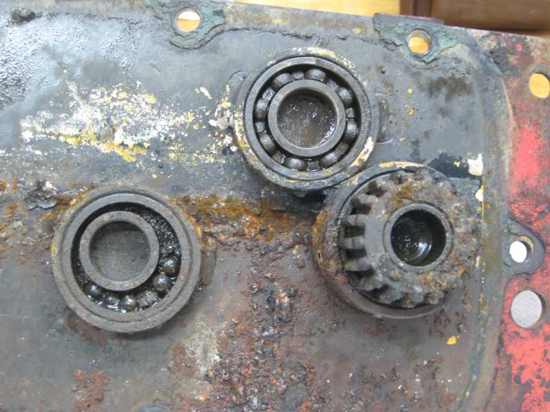

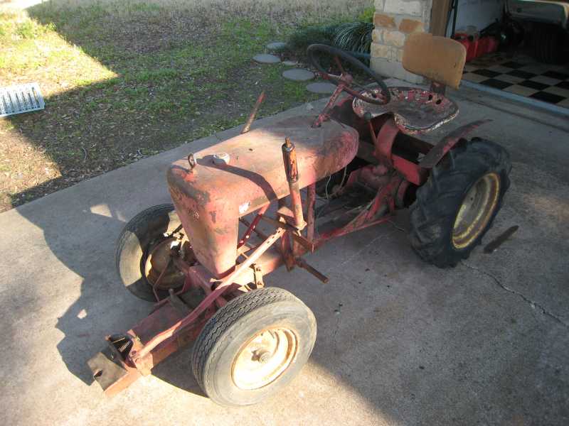

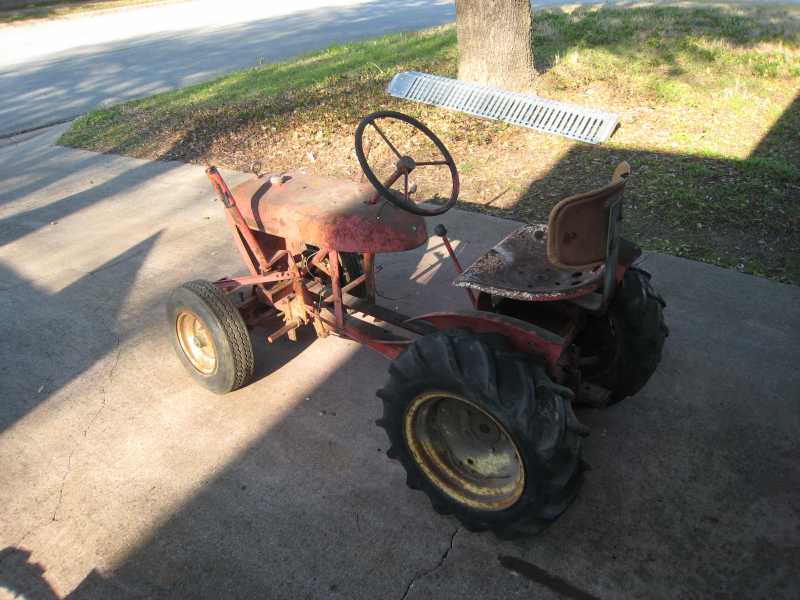

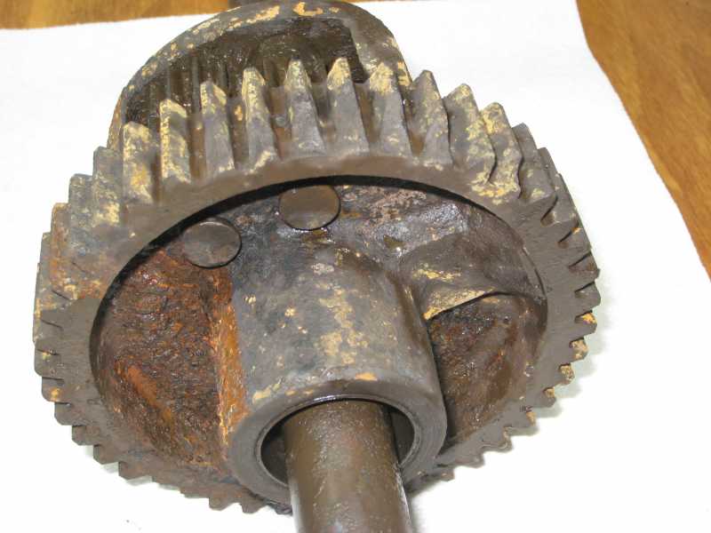

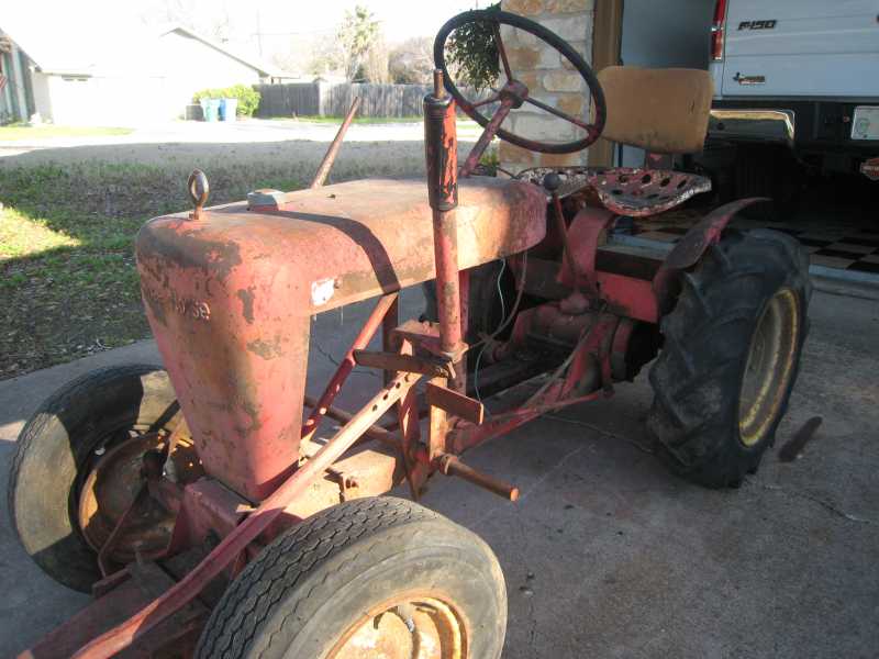

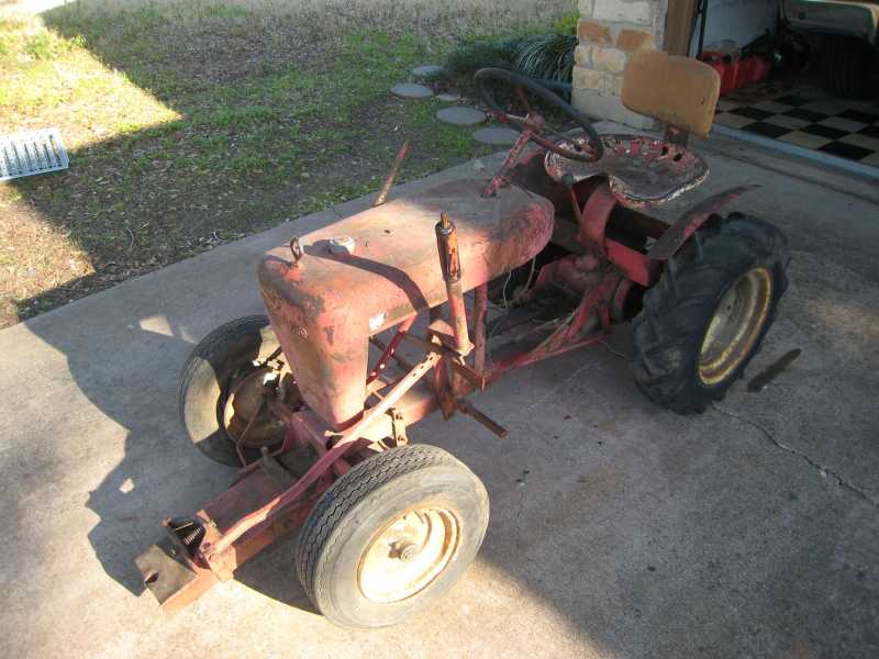

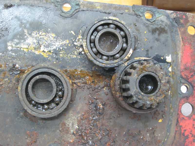

On Geno's prior Wheel Horse site I had started my RJ58 project and will continue to post updates and pictures on the new site. I know everybody likes pictures. Just a recap of where I am now. The tractor has been taken apart and cleaned. This week the big parts are to be sand blasted and primed, The transmission was locked up and when I tore it apart, I found broken teeth, lots of rust and the trans fluid had solidified .I have since completed the trans rebuild, found replacement gears on E-bay, put in new bearings and new bushings, and seals and gaskets. Today I was able to paint the trans and tomorrow I will put on pulleys and brake band and post some pictures. Here are some before
pictures of the tractor and trans gears.

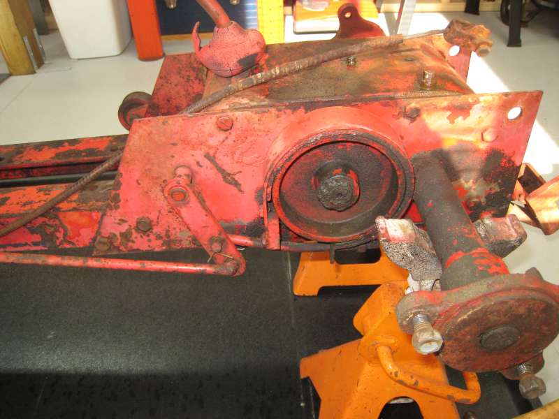

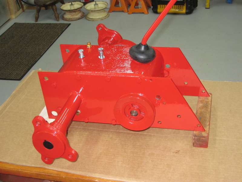

11 Mar 2015 14:28 - 11 Mar 2015 20:38 #726 by motor12

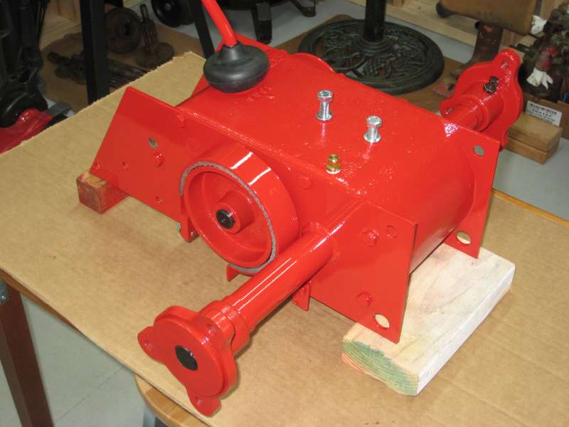

Finished up the trans and attached a couple pulleys. Here is a before and after picture.

11 Mar 2015 15:09 #727 by nappypappy
Replied by nappypappy on topic Rj 58 progress
wow looks like new now or even better than new.....great job :cool
11 Mar 2015 18:46 #735 by Geno
What a handful, especially the welded on brake pulley. You do some nice work Motor. :goodjob
