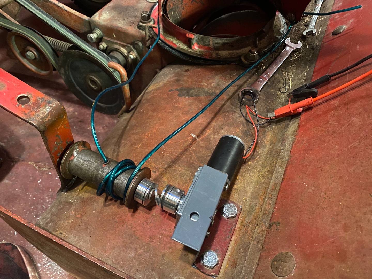

Been spending the past couple days working on this. It’s almost done now. It does work pretty good now and the motor has more than enough power plus it’s a good speed as well. Last thing I need to do is put a peg in the middle of the snowblower for the cables to route around so they stay on the spool.
08 Jan 2021 19:16 #16604 by JustinW.73
Replied by JustinW.73 on topic Snowblower Electric Chute Mod
Oh and I will need a different coupler as you can see. If anyone comes across an 8mm to 12mm universal joint style coupler let me know.

Nice work, I am thinking of the same mod on SnoZilla. But using a seat motor.
09 Jan 2021 11:03 #16609 by Geno
Replied by Geno on topic Snowblower Electric Chute Mod
I like a gear regulator power window motor for me, tons of torque. :tounge2
