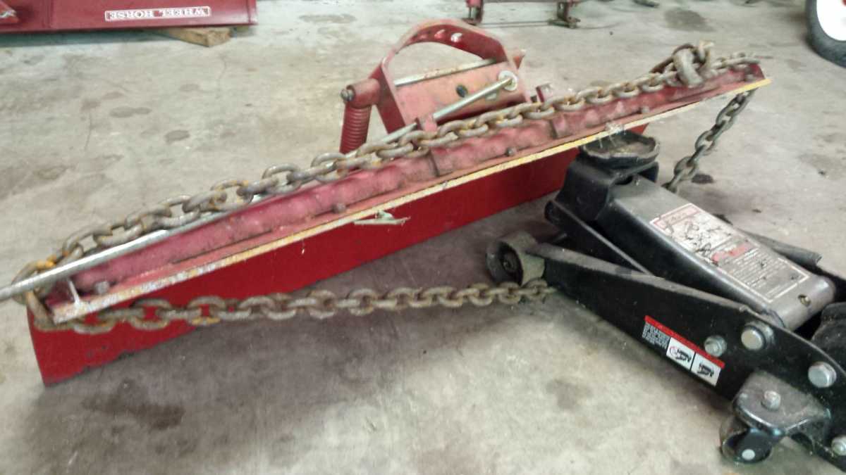

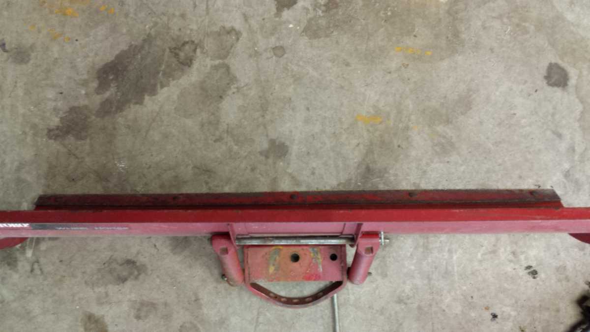

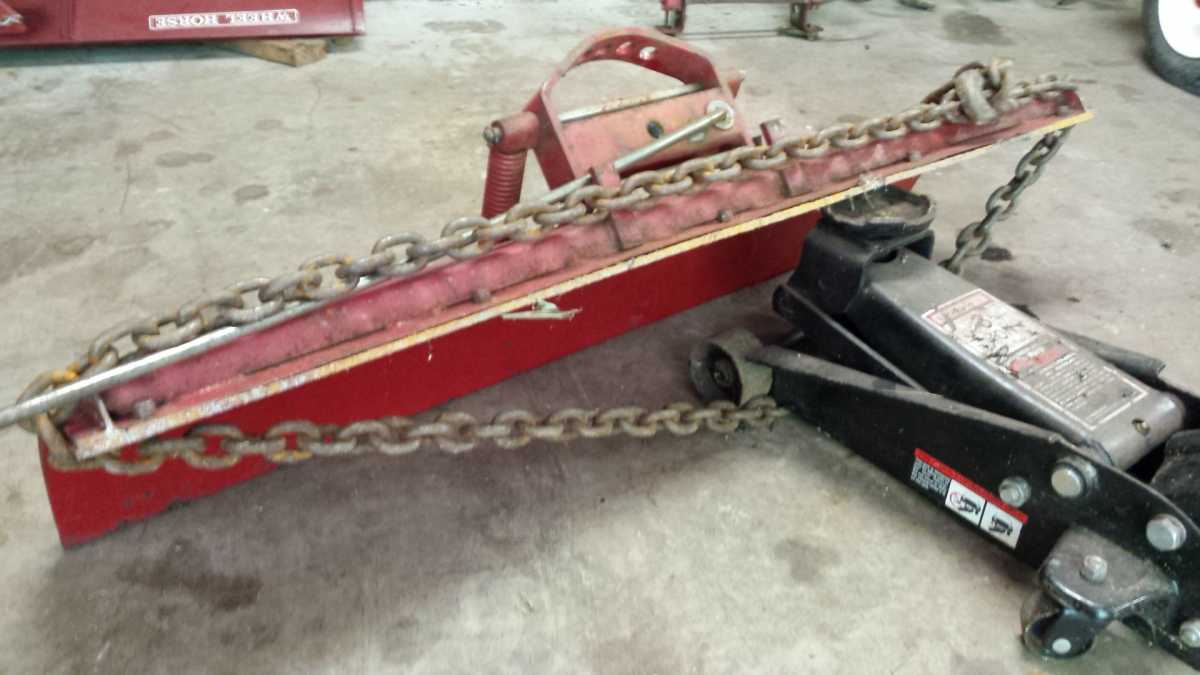

Just about every plow I have owned (not that many) have been bent from years of use.....the outside cutting areas take on a lot of stress and bend back a bit while the tops bend forward....this is how I straighten them with tools and equipment most of us have in our garage.....a chain and floor jack....
Afterwards....
Afterwards....

Great idea Bob, I will put that in the gray matter file.

Nice idea Bob. Just make sure the chain doesn't slip lol.
I used to put a small piece of wood under the high spot and back a tractor up on it a little to straighten it. Oops, let me clarify the Kubota backhoe end or the International 756 Turbo kind of tractor... :rolling
Now I use the forklift. The common household man tools is brilliant.
