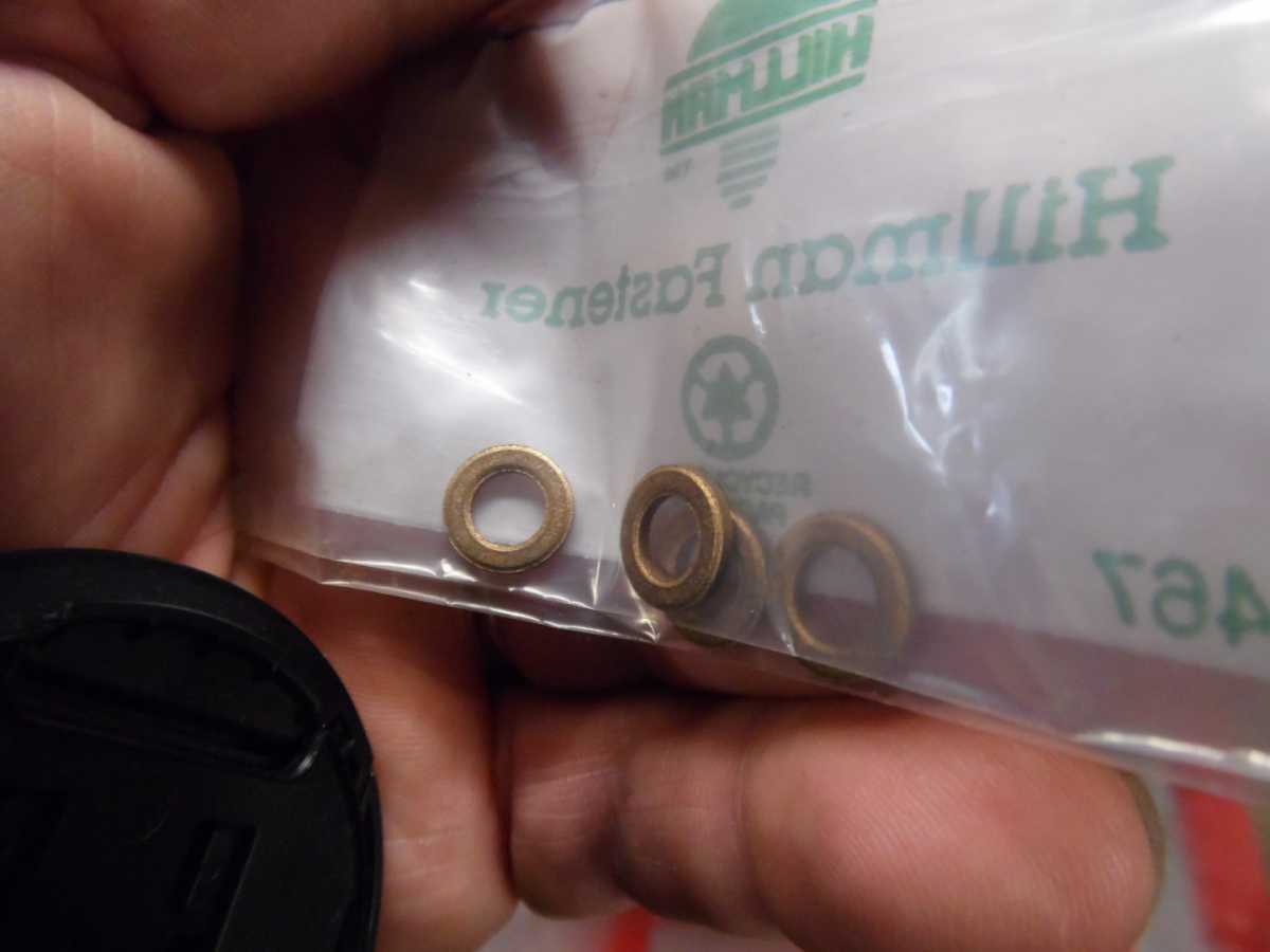

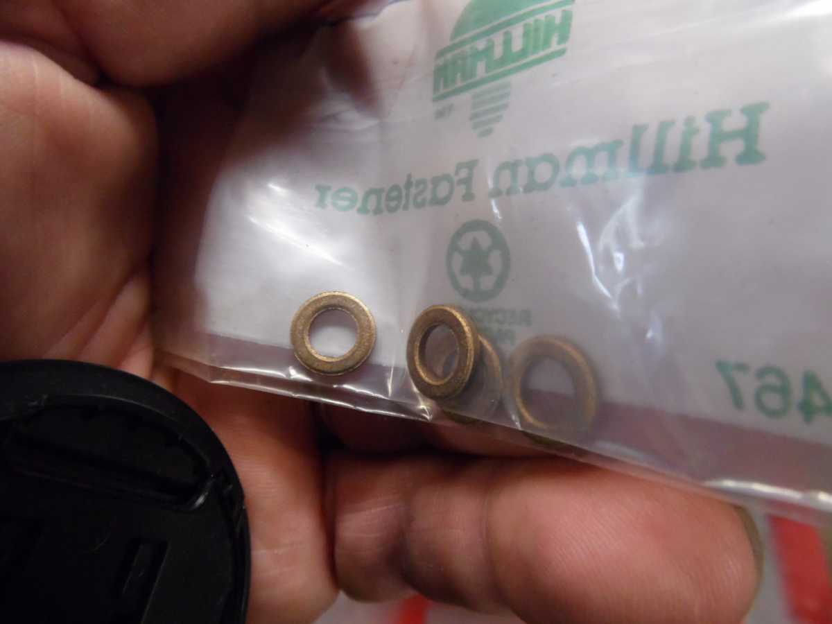

03 Jul 2015 09:12 - 03 Jul 2015 09:45 #6475
Great tip Bob and it really works well. Done a couple of them using 2 Hillman 58087-A 1/4 x 7/16 x 1/16 bronze thrust bearings stacked in the recess. A single would probably work okay but @ $.80 ea from Ace Hardware doubling them up seemed like a good idea.
Replied by M Bailey on topic Throttle shaft bushing fix
Geno wrote: I think Major has done this on a carb, someone around here has.
