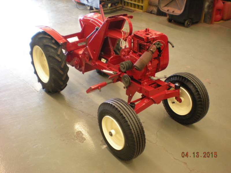

Looking to see what works best for getting these pipes out of the engine blocks. What has worked best for you guys?

Here's what we're working on -

Geno I've had good luck with an 18" Rigid pipe wrench. Easier to remove if the block is warmed up first and a little Kroil on the threads helps out too!

OK...here is what I do....I cut the pipe off about 1/2 inch away form the block.....then take a sawzall and cut the pipe at two places longwise....not quite through but enough to weaken the pipe wall....then take a punch and hammer it towards the inside.....

I soaked mine for about 4 days with PB Blaster. Used a sharp chisel to break it loose. Worked but I was sweating all the while.

I've been putting PB Blaster on it for about 5 days. I got out the 2' pipe wrench and took a hammer to the end of it and gave it some hammer action and she came out. I like hammer action better than constant pressure, seems to break less things overall, sort of like an impact. Thanks for all the advise guys.
