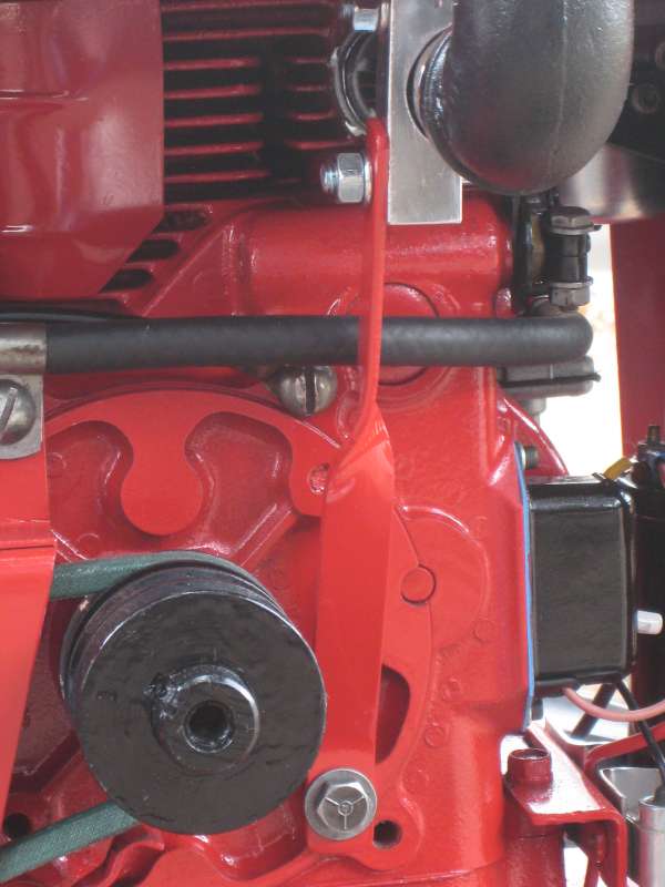

Nappypappy, I used a piece of aluminum angle and a u-bolt for the lower clamp that is attached to the bracket.nappypappy wrote:
Very nice and is that a u clamp?motor12 wrote: My 854 with stack and a shot of the support bracket.
Also I like the way that fuel line is run.... :goodjob

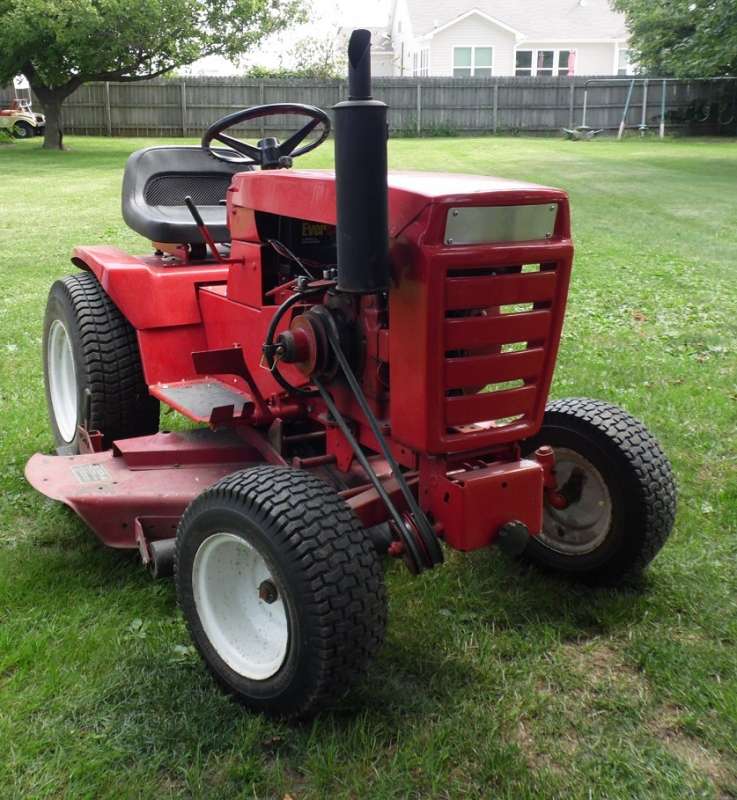

Pappy that is the Ford New Holland part number for the muffler. It has a 1.5" ID inlet and 1.5" OD outlet, it's 17" long. Just do a search for FD1110 and you'll find lots of sources for 'em. This one came from ebay. A 1 1/2" OD sweeping 90 bolts it to the manifold.
Replied by M Bailey on topic Show us your stacks!
nappypappy wrote:
The 416-8 stack....what is that part number for or where?M Bailey wrote: Here's a couple,
416-8 with an 8N PN# FD1110
C-101 with a Kohler PN # 237550S
Toro number?

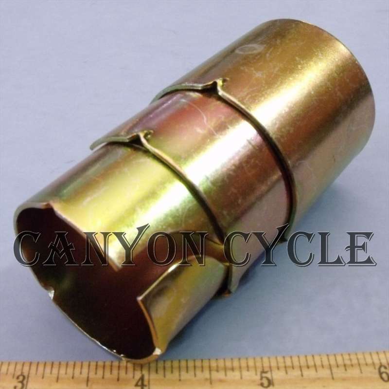

Nice.....new products I never knew existed.....thanks major.....M Bailey wrote: These exhaust reducer bushings are life savers and save a lot of :angry2
