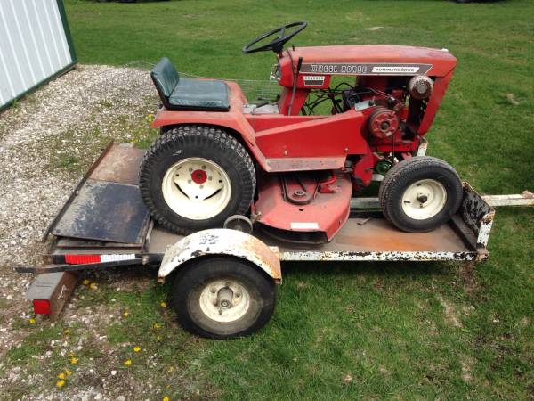

Does the charger 12 auto have a front mount attachment point for a snowblower? Heres the pic of the one I want to get. If it doesn't can I hook up a snowblower some other way?
05 May 2015 08:14 #4086 by Geno
Replied by Geno on topic Question about Charger 12.
Easiest way is to put a front Tach A Matic bracket on the front. Wheel Horse made one that had 2 brackets welded to the Tach A Matic on the sides that bolted to the front 2 open holes in the frame. Easy to make. I have one around here somewhere I can try to get a pic of. :)
