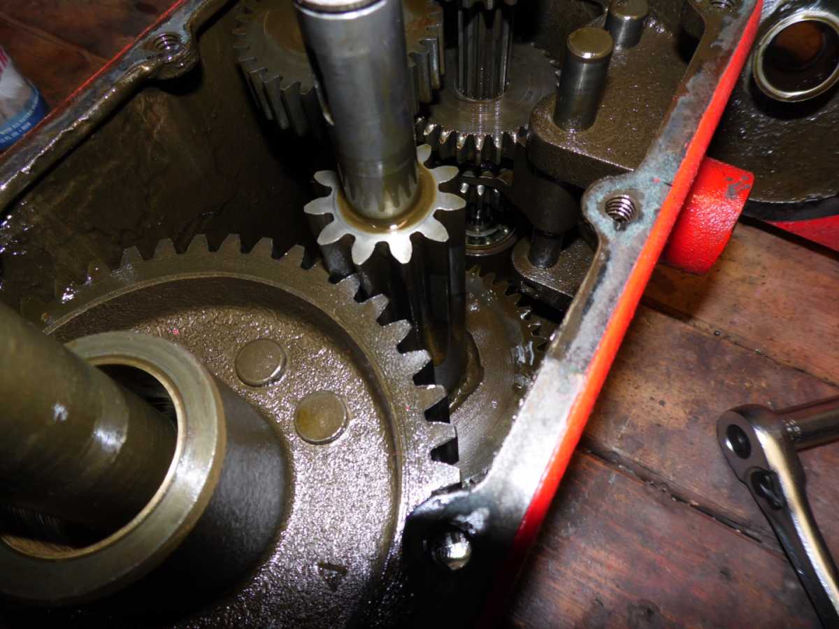

A few pics of a 5010 I rebuilt last fall

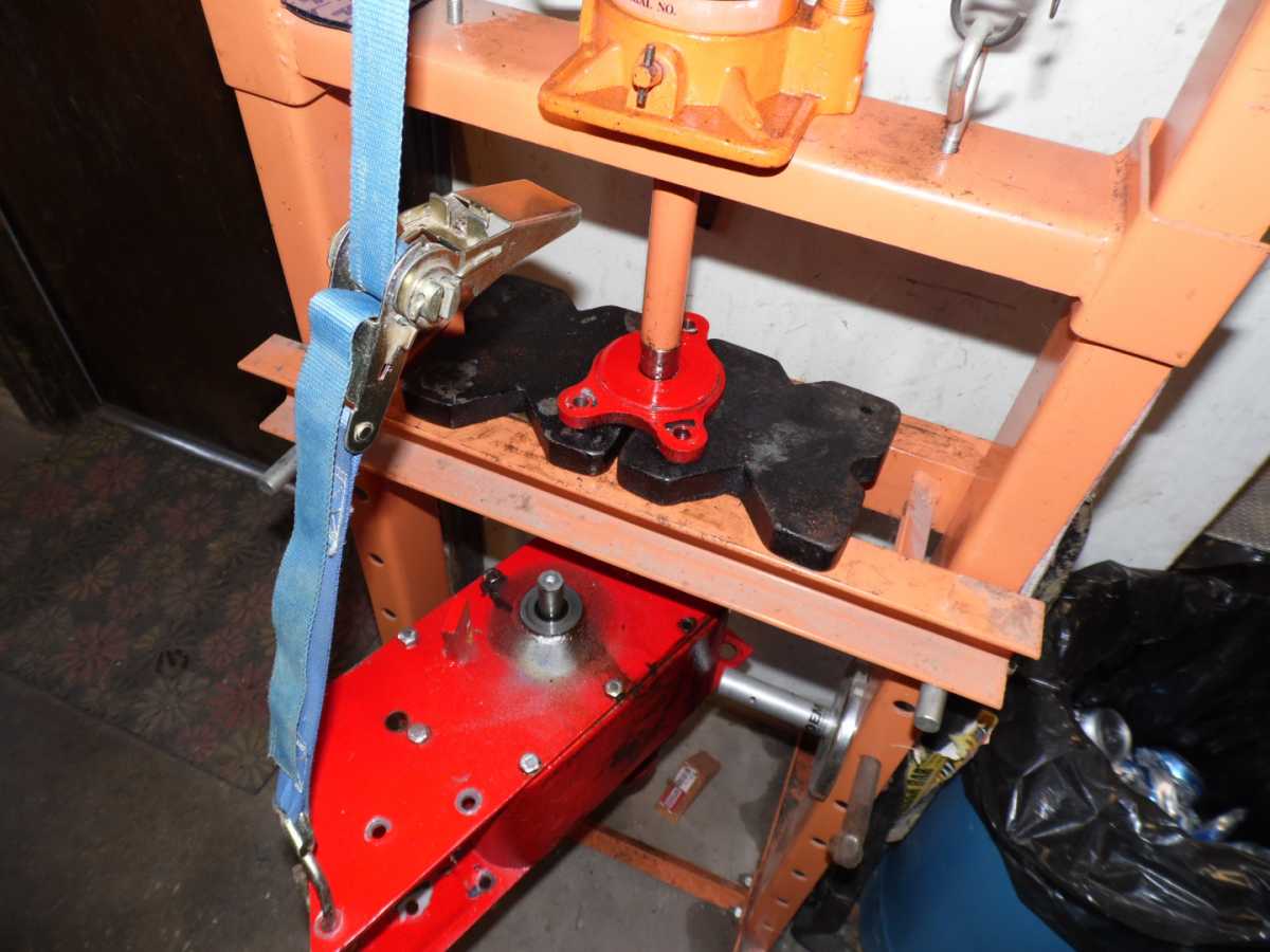

Pressing out the hubs

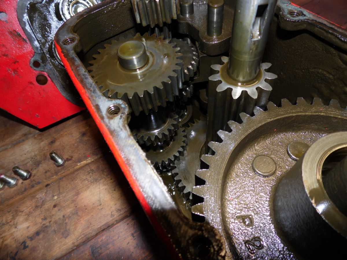

Internals

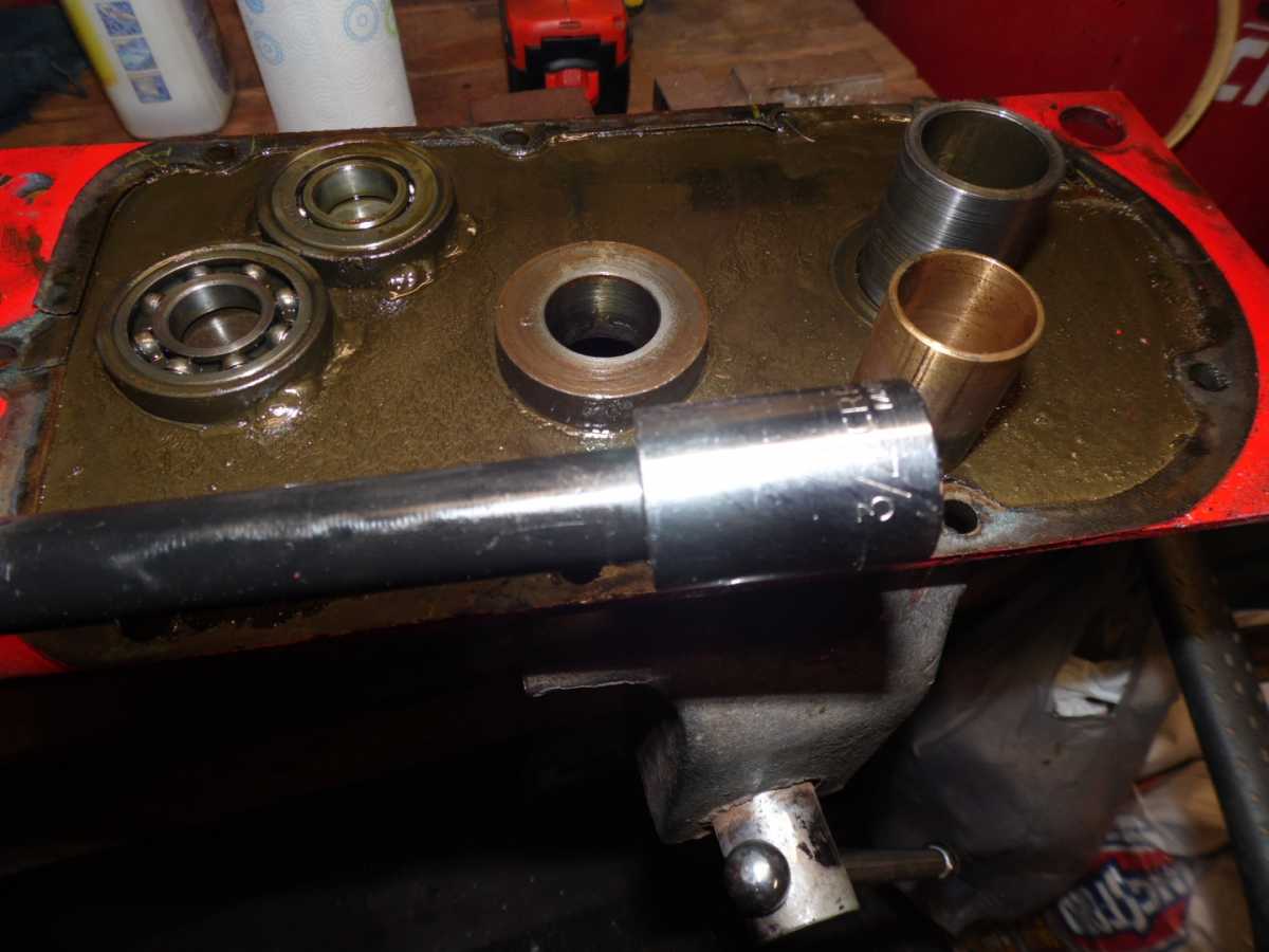

Axle bushing removal tool....

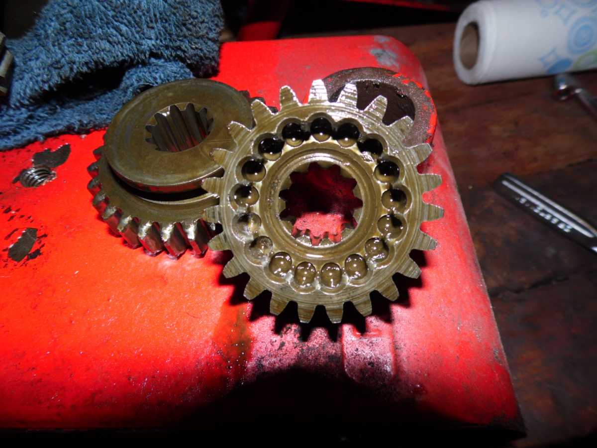

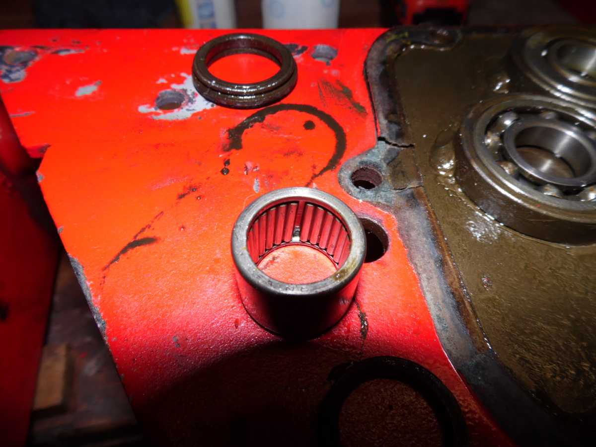

Bad brake shaft bearing (missing a needle) and seal
Closeup of the 2-3 gear

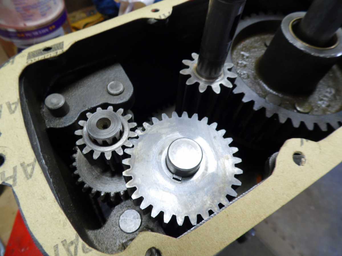

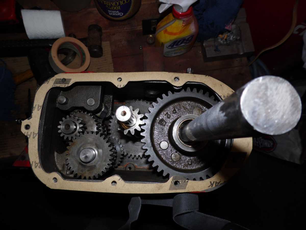

Reassembly nearly complete.

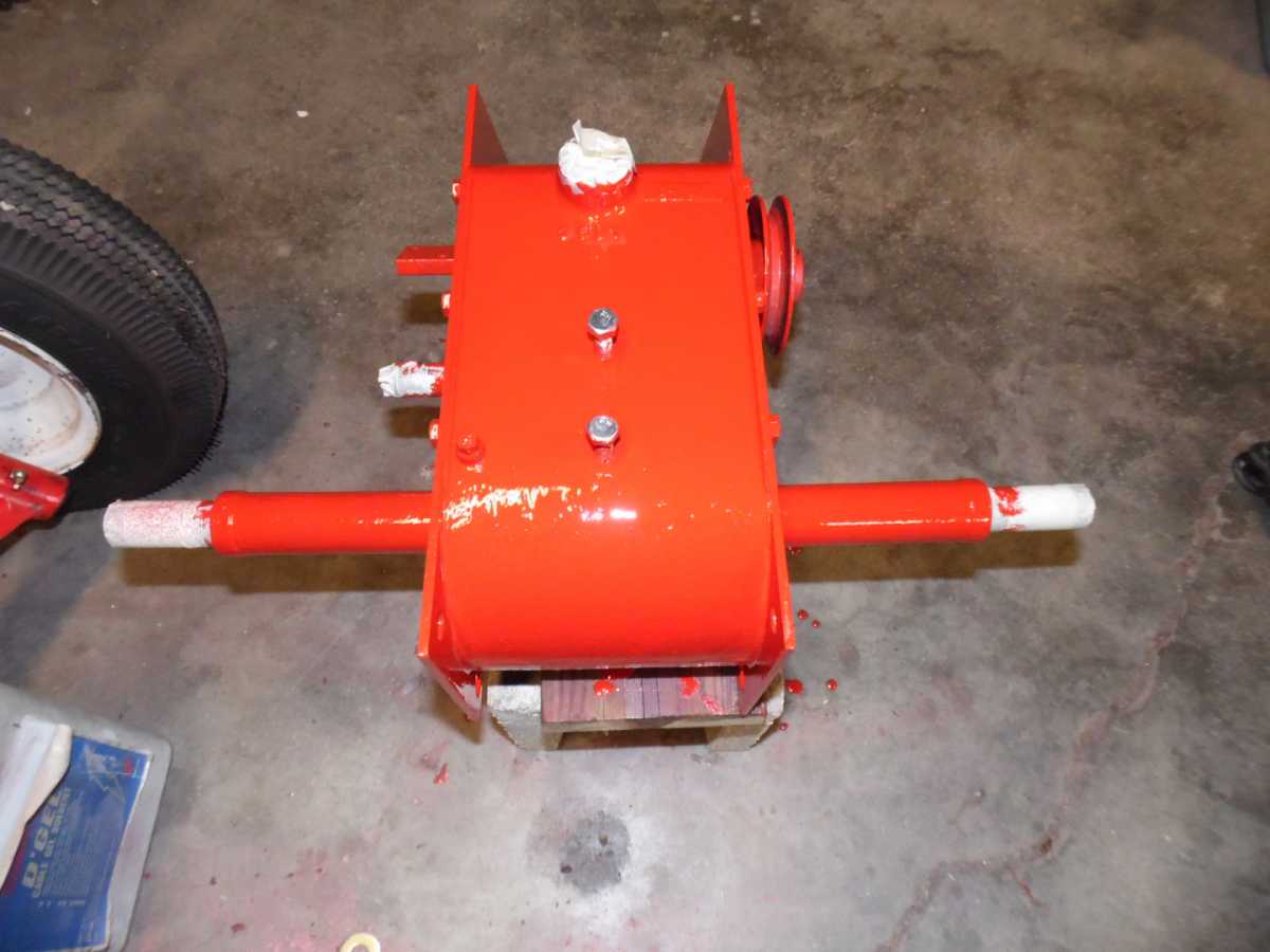

Buttoned back up and a fresh coat of paint
Wish I'd taken more pics of the reassembly but my camera crew was late for work that day :rolling

I could not get by without a good hydraulic press. That is the one thing in my garage that gets used continually, either for my needs or for the family/neighbors! It's a tool you'll never regret buying!!

Same press as mine Bob, good price too. Money well spent for sure! I never would have got those hubs off without it.
