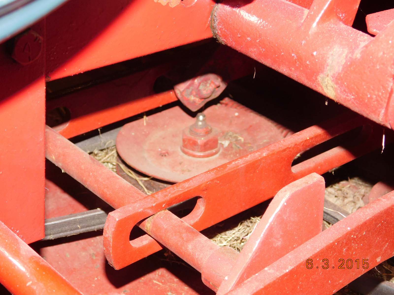

So I decided to move the deck to my 88 520H that is running and looking decent. I had a 42"RD on it that I never liked. Anyway, I swapped the decks and started the engine. Everything sounded OK until I used the hydraulics to lift the deck, that's when the sparks started to fly. I dropped the lift and tried to mow a bit just to test it. Then I took a close look, The grease zerk on the center spindle is gone and the treads on the top of spindle shaft are bozo'd. The lift bar was hitting the center spindle. Something is clearly not right here.
I'm going to dis-mount the deck tomorrow and take a close look. I almost looks like the lift bar is dropping down dead center over the spindle and not off to the side like I would expect. Not sure what to do from here. I looked at the lift bar on my 93 and its centered too and but looks like its been ground down a bit on the bottom. I might try that. Maybe, I've got some wrong parts causing problems. I've had that happen way too many times on old tractors. My gut feeling is that something is wrong with lift linkage parts. They seem too close to the deck. I had problems getting the belt on.

M Bailey wrote: Kurt I'd take a close look at the tach-a-matic and make sure the carriage is seated properly and the hitch shaft fork (item 1) is engaged in the bar. After that check the carriage mounts and make sure they haven't shifted (items 15-17). Next check the transport stops (19) on each side and raise them up, this might be part of the problem if they are set too low.
Well, I pulled the deck and checked things out.
Here is the problem
1. The spindle shaft is toast - the grease zerk went off sideways and wallered out the threaded hole. I think I could fix it, but the spindle is just not that expensive, so I'll order one..
2. The carriage was seated in the tach-a-matic as it should be. Nice and tight
3. The carriage mounts (15-17) are tight and where they belong.
4. The transport locks were in the full down position (or is that full up). The bolts were all the way down.
My plan - raise the transport lock bolts to the top. Grind a bit off the bottom of the lift bar. We'll see what happens. I'll order a new spindle and replace that later.

I just ground the end of the lift bar down about 1/8" and now it clearing the spindle, but not by much. Maybe 1/16" At least I've got a mower.
I replaced that lift bar several years ago. When I bought the tractor it was broken. I wonder if I got the wrong one, or if I got it installed wrong. As I remember (and that's tough on this old bald and gray head) that rod can only go in one way. Looks like I have more work to do.
