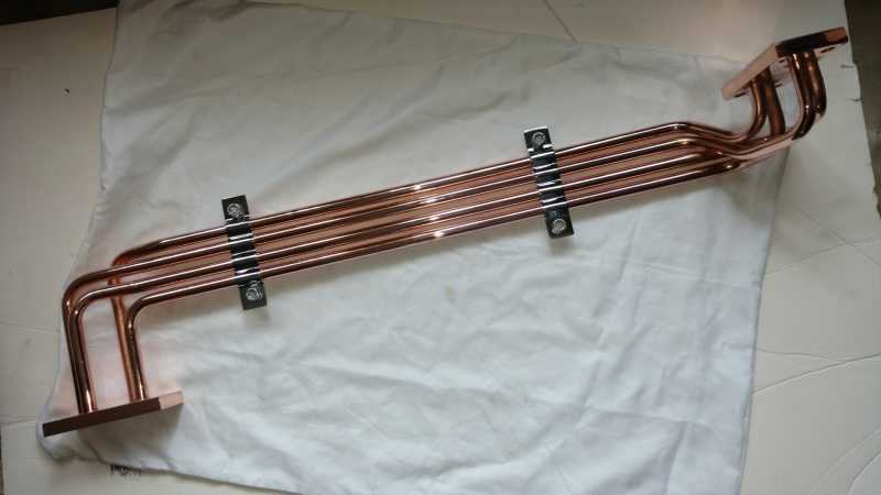

P.S. I have prepped the hydro pump to motor manifold for clear coating to prevent tarnish or corrosion of the decorative polished copper plating.
