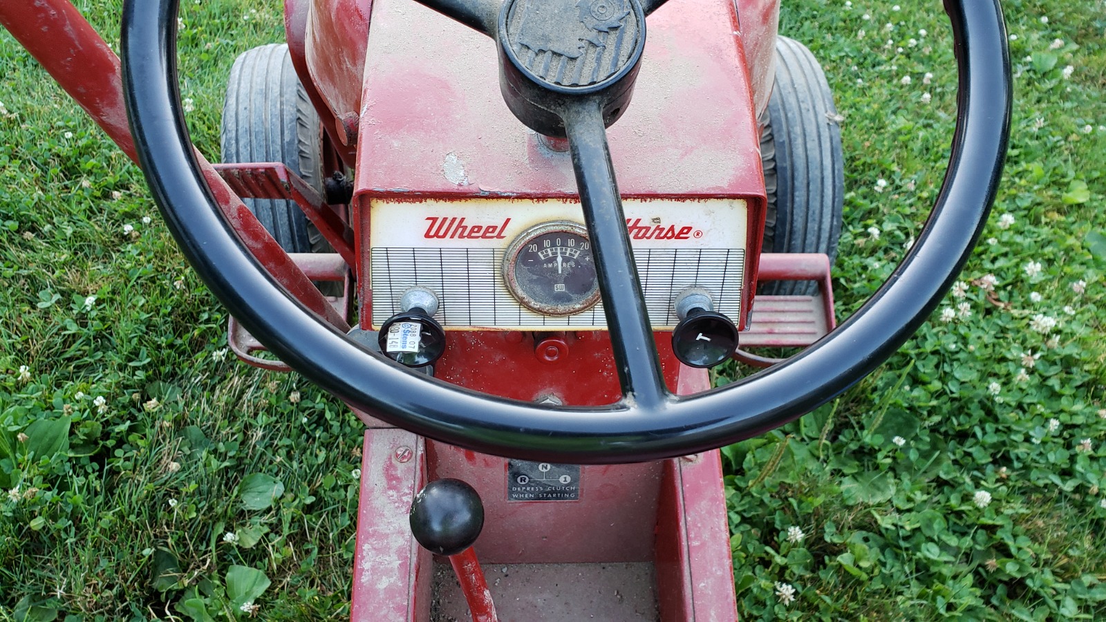

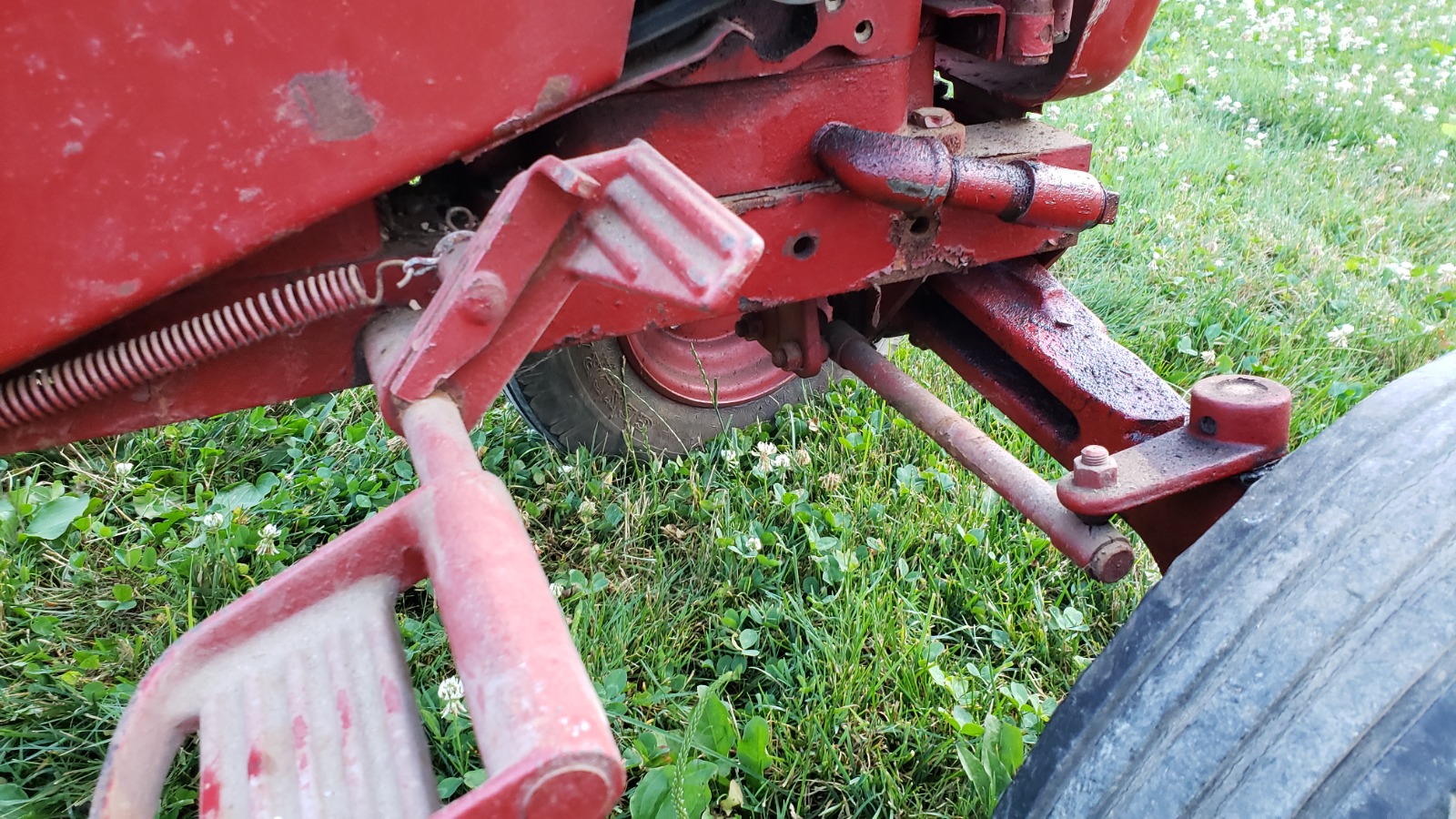

Haven't put anything in here for awhile but Jeremy and prob some of the family will be following along on this one. He's been a member here for over 6 years but like most peeps are just the reading type.
His family had a Wheel Horse dealership for over 40 years so it will be real nice to talk about parts and fixes with someone that knowledgeable. It got started on this afternoon so here it is.

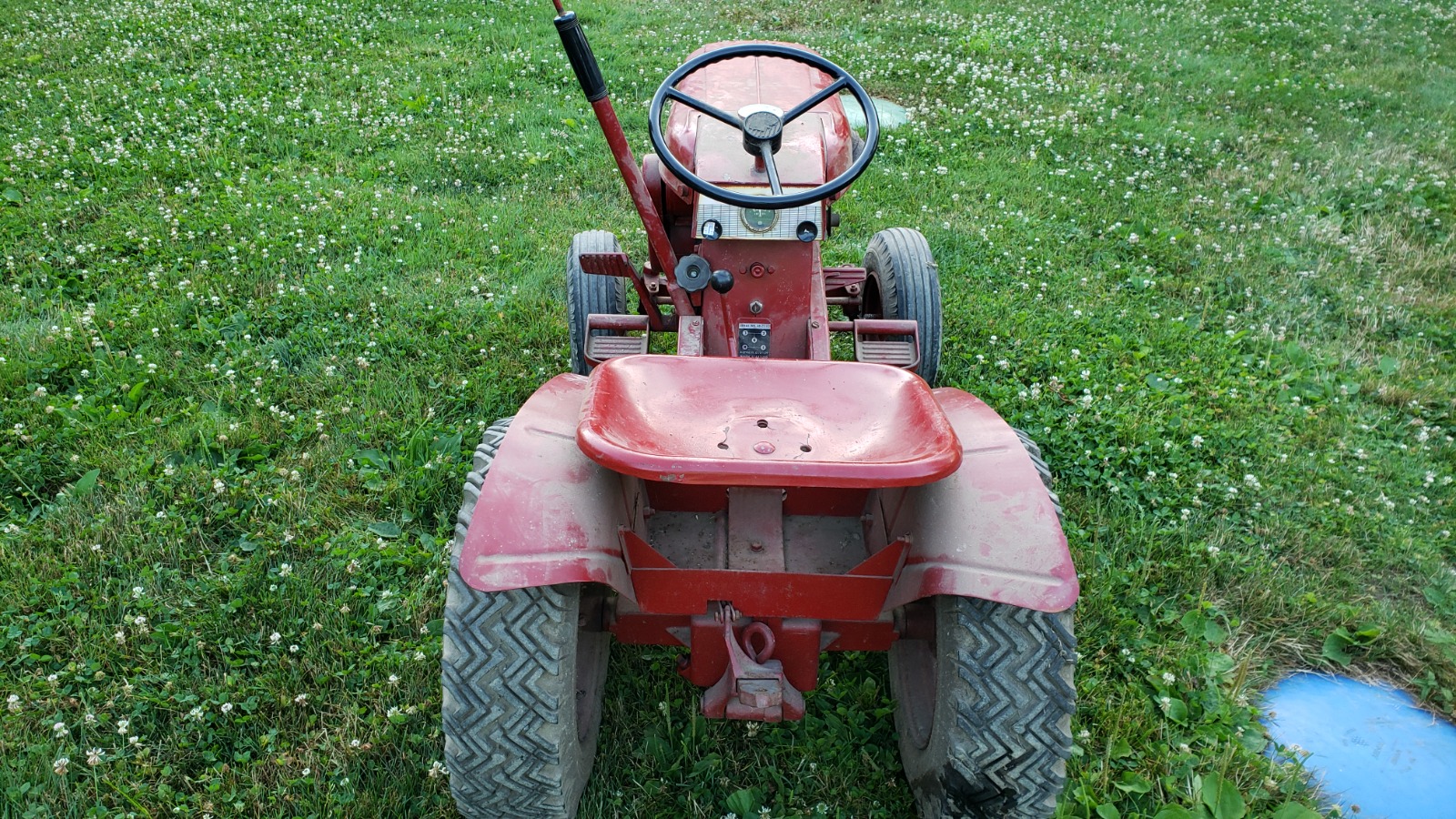

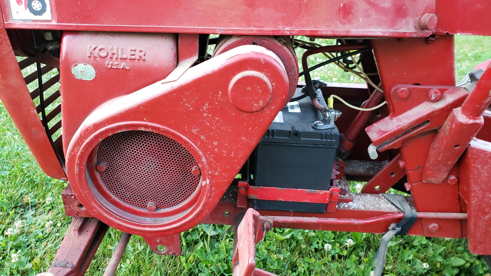

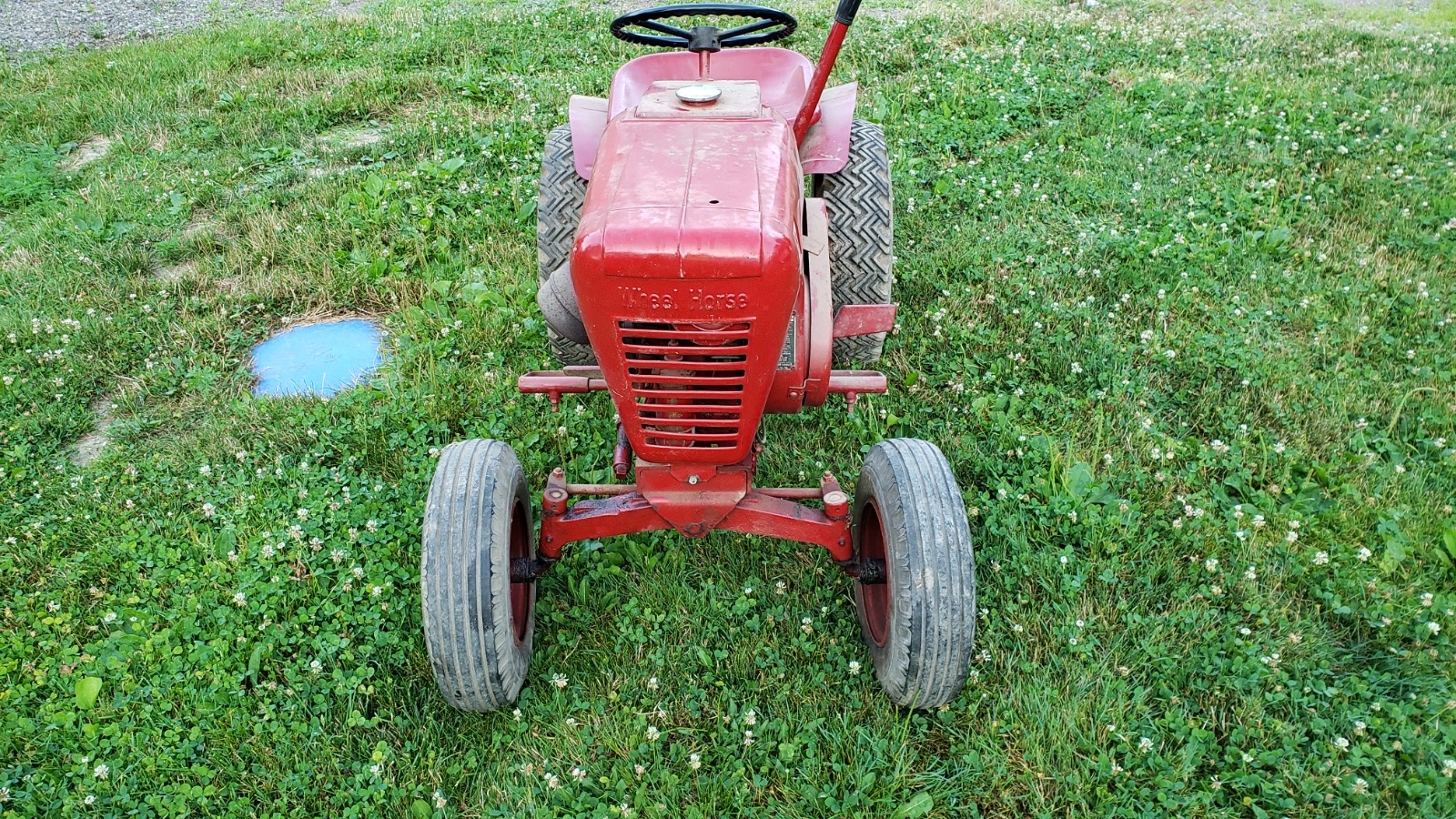

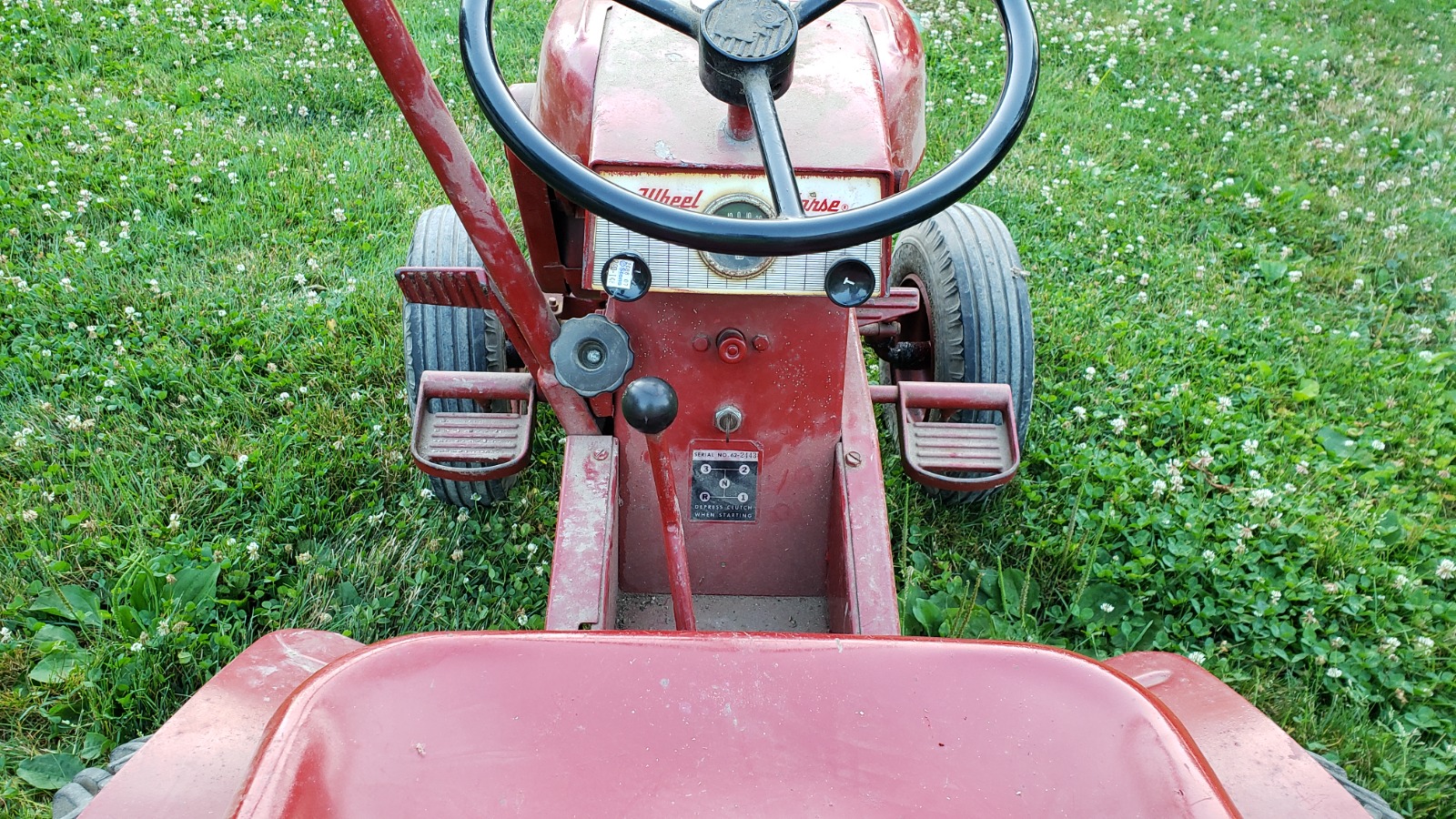

Some before pics.
Some before pics.

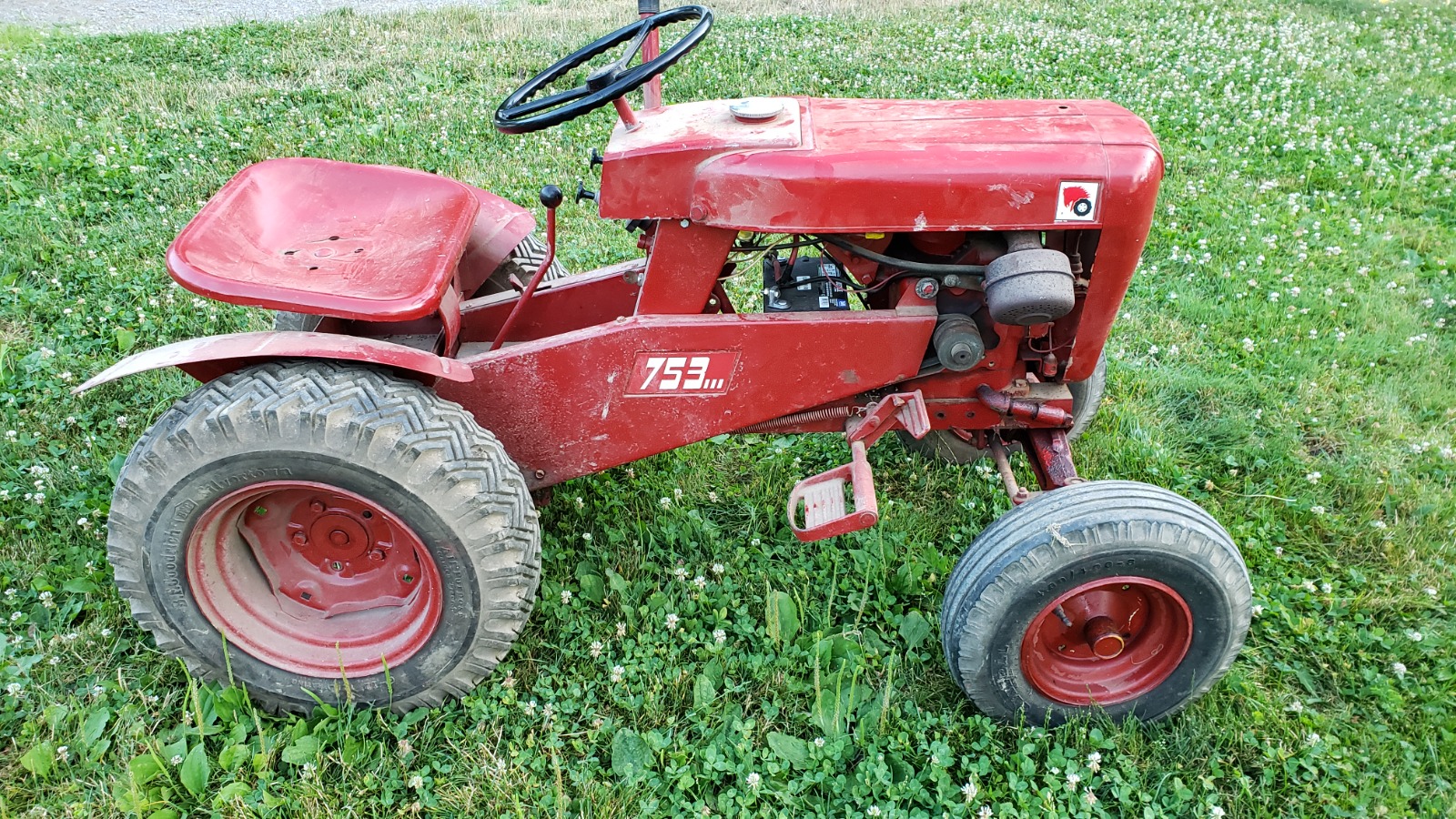

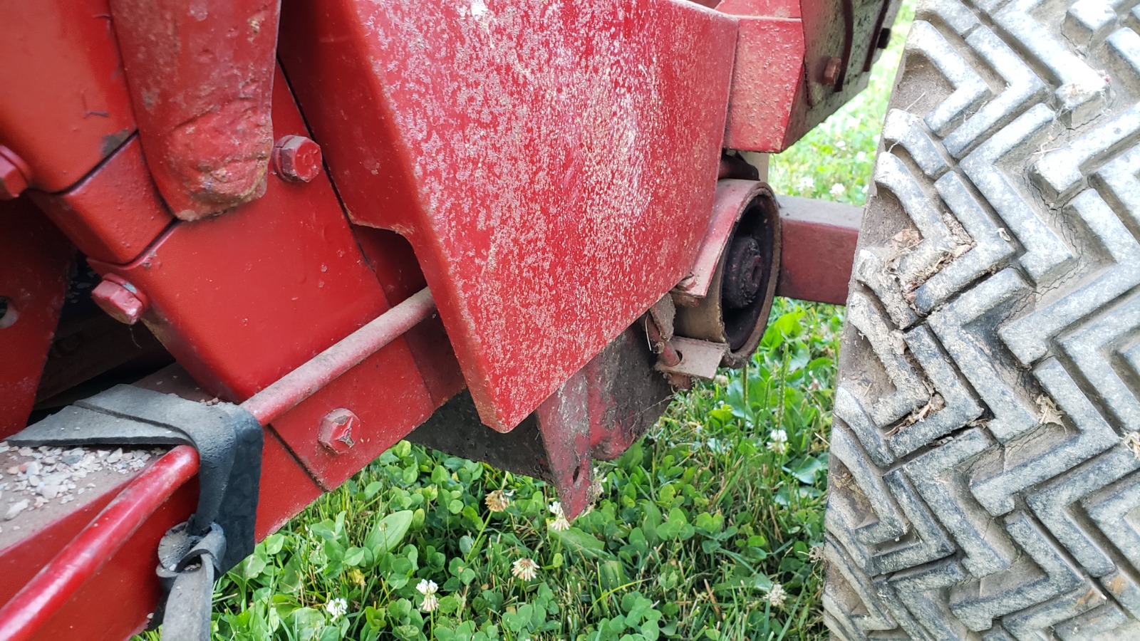

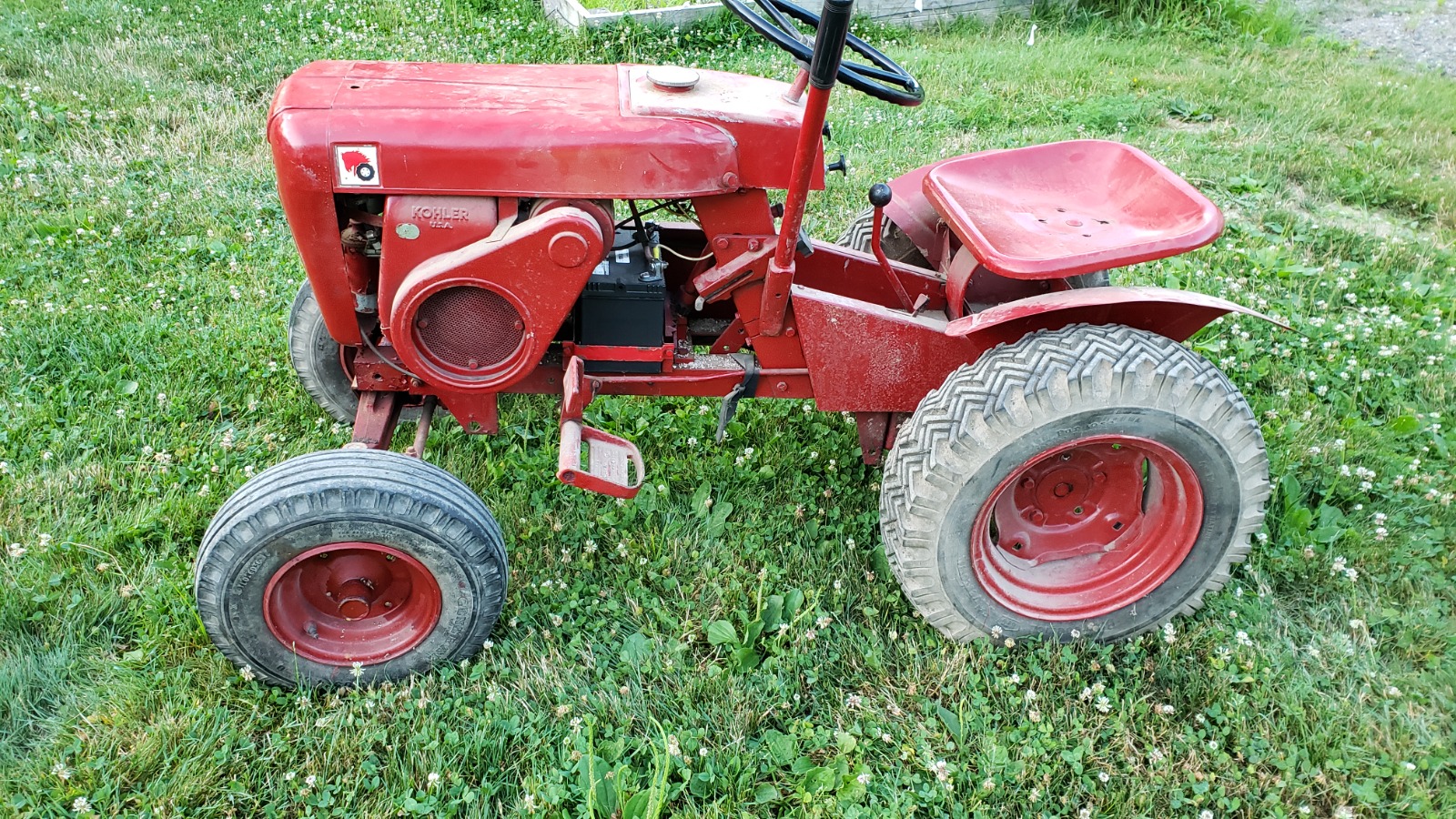

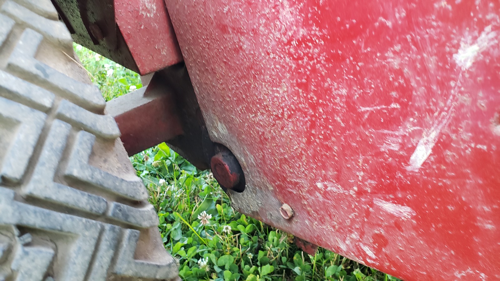

A few general before pics and the fuel tank leaks after the hood was taken off this morning.

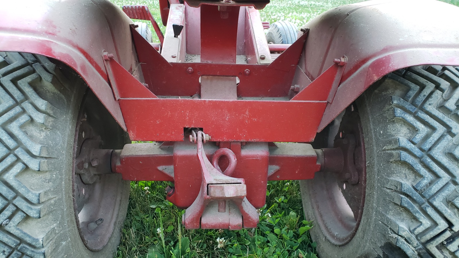

Then the fun began.. The rear slot hitch pin was coming out the hard way. I do them with a 4" x 1/16 cutting wheel with the guard removed but of course this is not recommended... It still makes me nervous to do things this way, I was hurt doing something like this about 30 years ago on a car I was restoring when a disc shattered.
I also press out the outer pieces a lot so I'm used to it, but if anyone is doing this for the first time it's a tough thing to do even for me and with a special tool and receiver I made for the press. I made a press receiver on the lathe years ago that was bored for a pin to go into, and the 3/4" piece in the press for this has been turned down and tapered on the end so it doesn't bind up. There's not a lot of lip to put on the 1/2" blocks and still press the pin out so it's a careful operation to do. I don't like heating things unless it's a total last resort as it weakens and warps things.
The main thing I keep in mind other than safety is saving parts that aren't made anymore.
