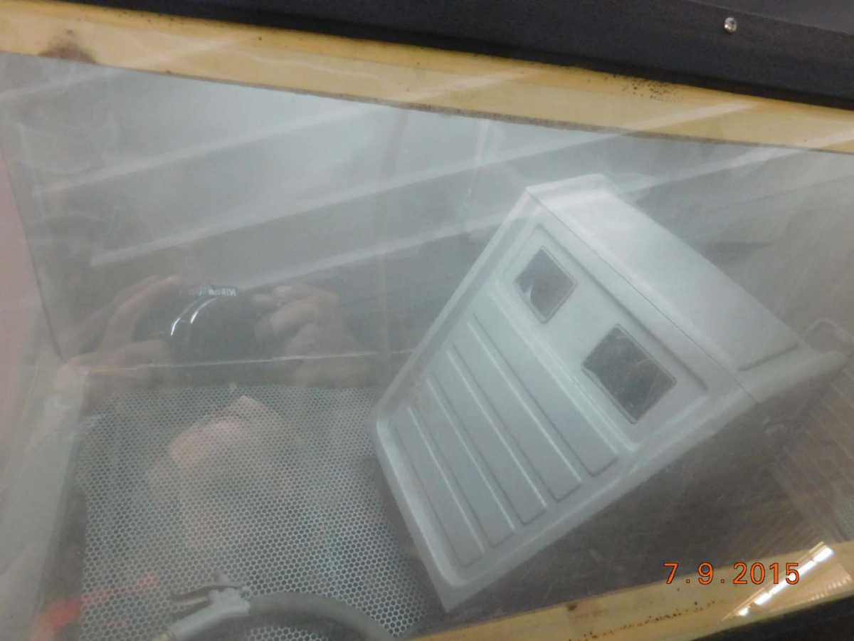

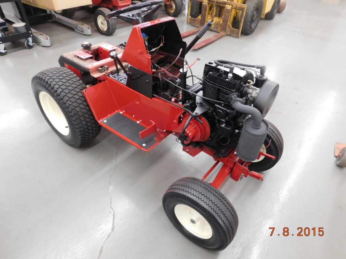

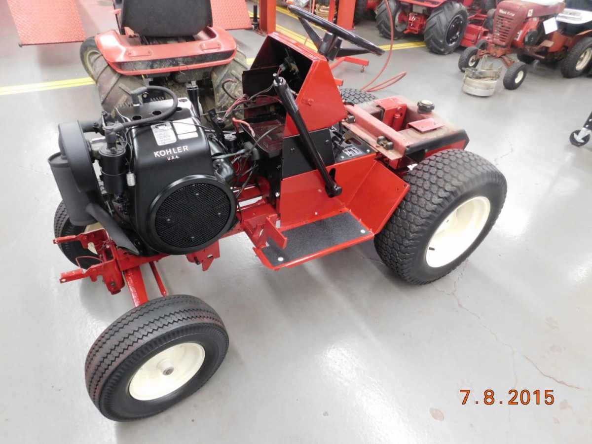

It's all done I think minus the hood, rear pan + seat. Didn't spend much time on it today, parts were all painted last night. The hood + rear pan are waiting on the pressure pot blaster nozzle, it shipped today. The rear pan is off of a 400 series and a suction blaster just won't do it very fast. They put some kind of super paint on the 3-500 series and that's why we even added the pressure pot to the unit in the first place. :)

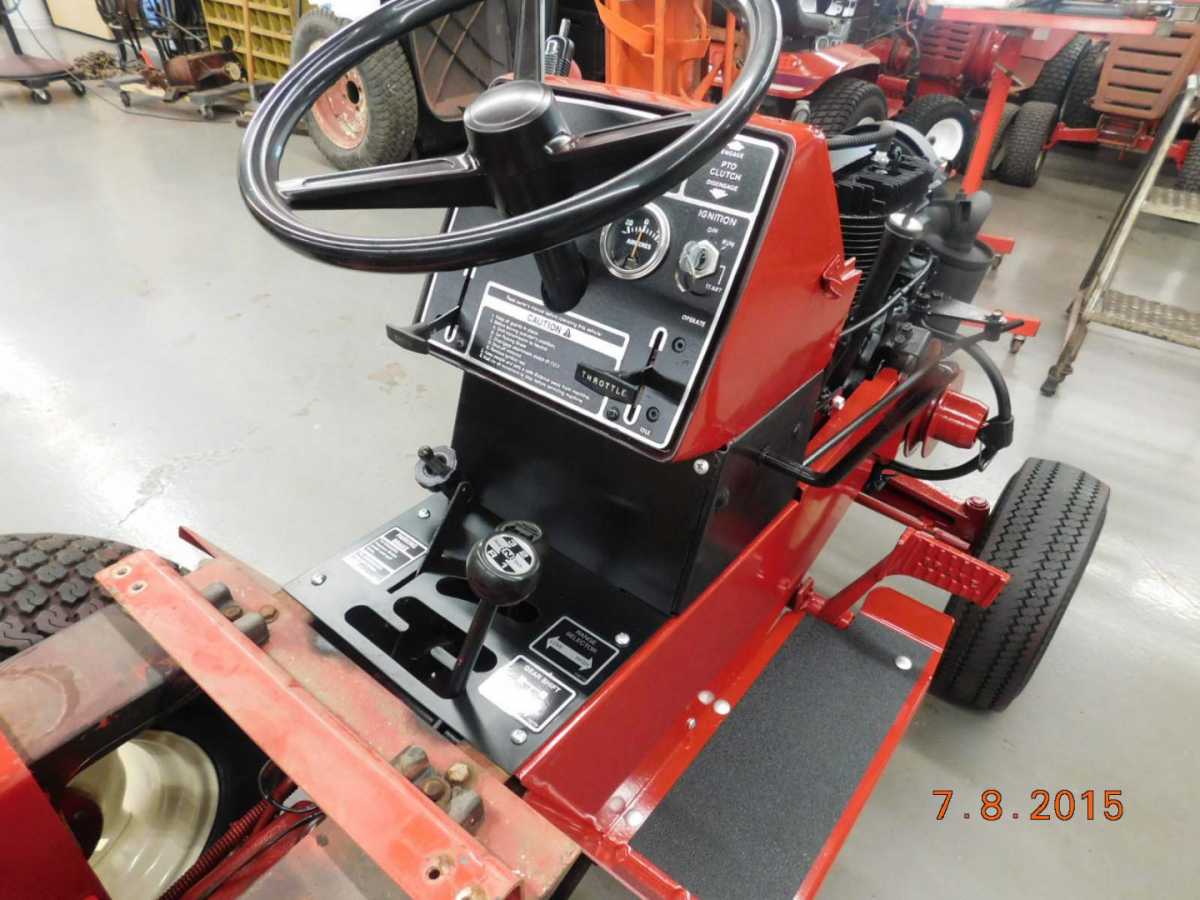

I am also officially blind from painting the dash lettering... :rolling3

1980 14HP. Came out as an automatic, the man who bought it new switched it over to an 8 speed. :)

Now dats nice!!!! how do you do the dash plates???? what paint pencils do you use??

The marker is a chiseled tip paint marker from Wal-Mart, in the craft section Bob. It's a DecoColor Premium, Silver, Oil based paint marker, made in Japan. It covers good and the tip is wider than the lines so they can be done in 1 pass. :)

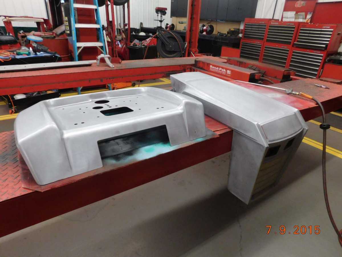

Getting ready to do a little painting. :)
09 Jul 2015 20:52 #6653 by JERSEYHAWG
Gene, that sandblaster is beast. You cant beat it.
