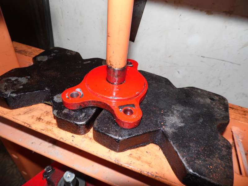

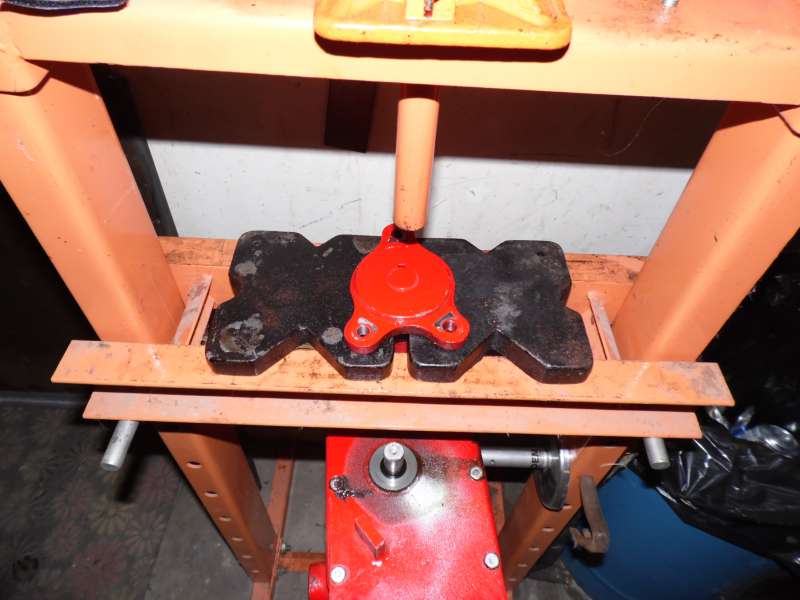

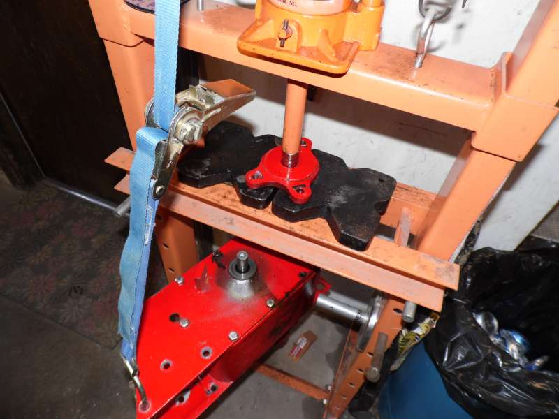

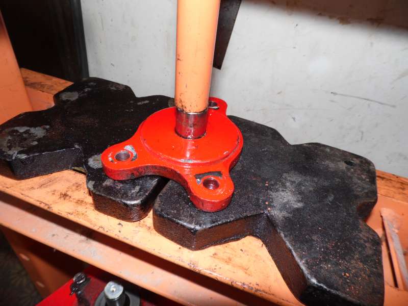

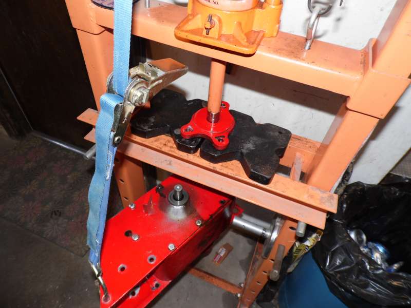

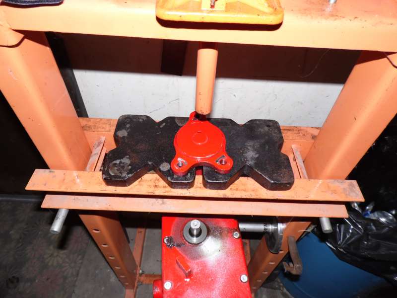

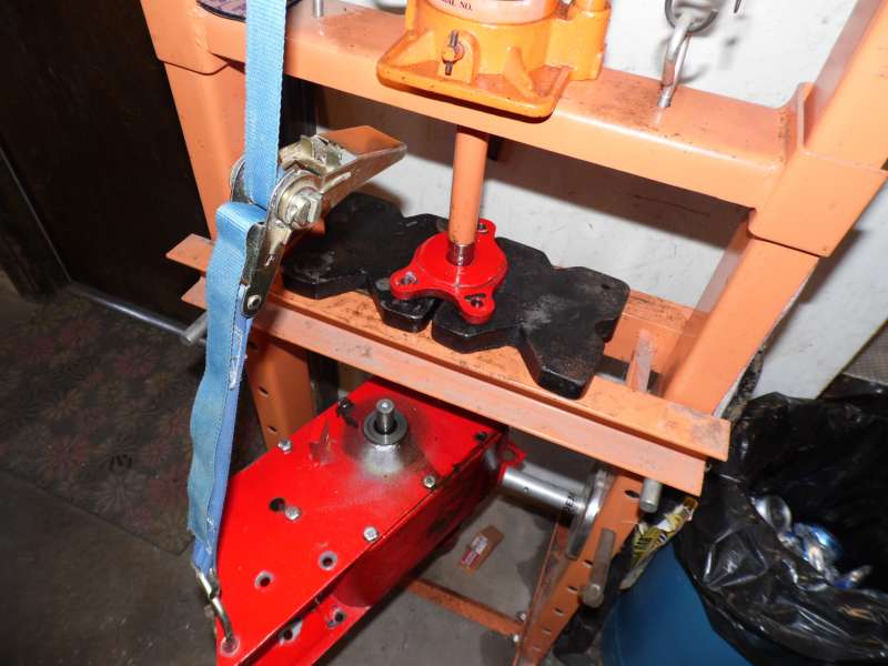

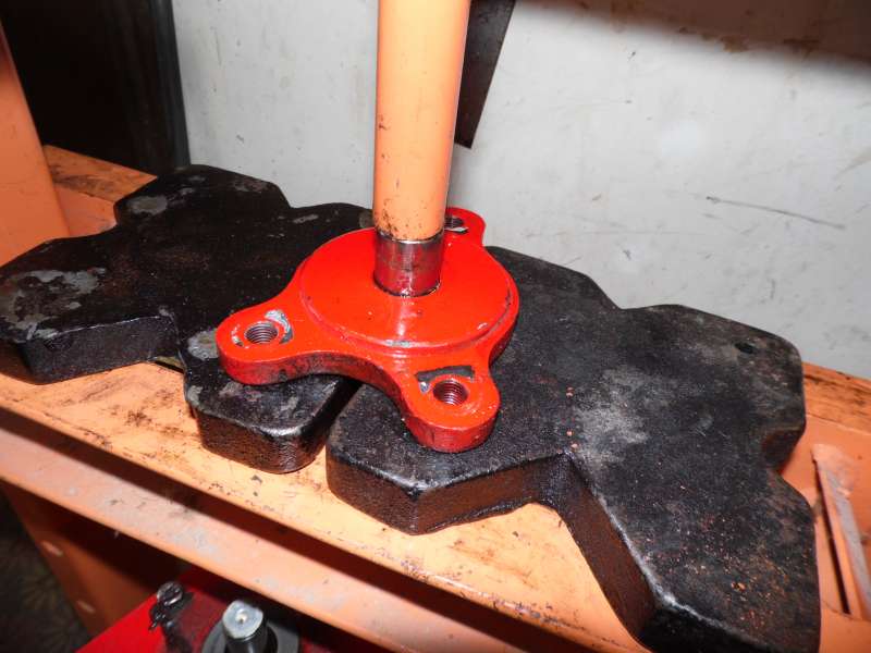

Here's how I removed the hubs on a 5010 Suburban transmission after 55 years of rust and abuse. This method works great, provided you have a press and a helper (to position the mandrels while you hold the transmission). The pics are self explanatory.
Just be sure to support the transmission with a strap first as shown in the last pic!
