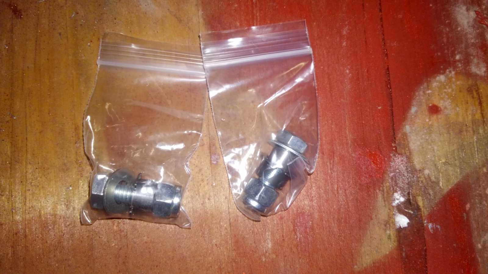

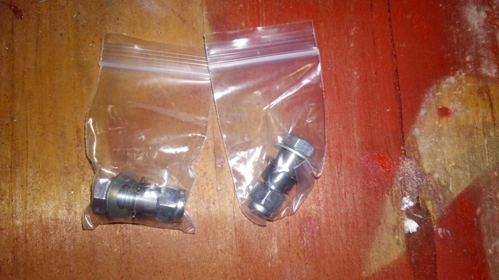

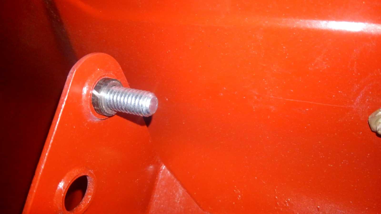

Working on the Wheel Horse 4937 Spacer. I need to ship out a few of these next week so they will be in the store shortly. I have something that works nicely for this and is the same OD and a little smaller ID which is good considering the original was a little too loose around the 3/8" bolt.
It will prob be sold separately for other uses and also as a kit with the bushing, bolt, and lock nut for the seat flip setups. The parts breakdown pics are below. :thumb1

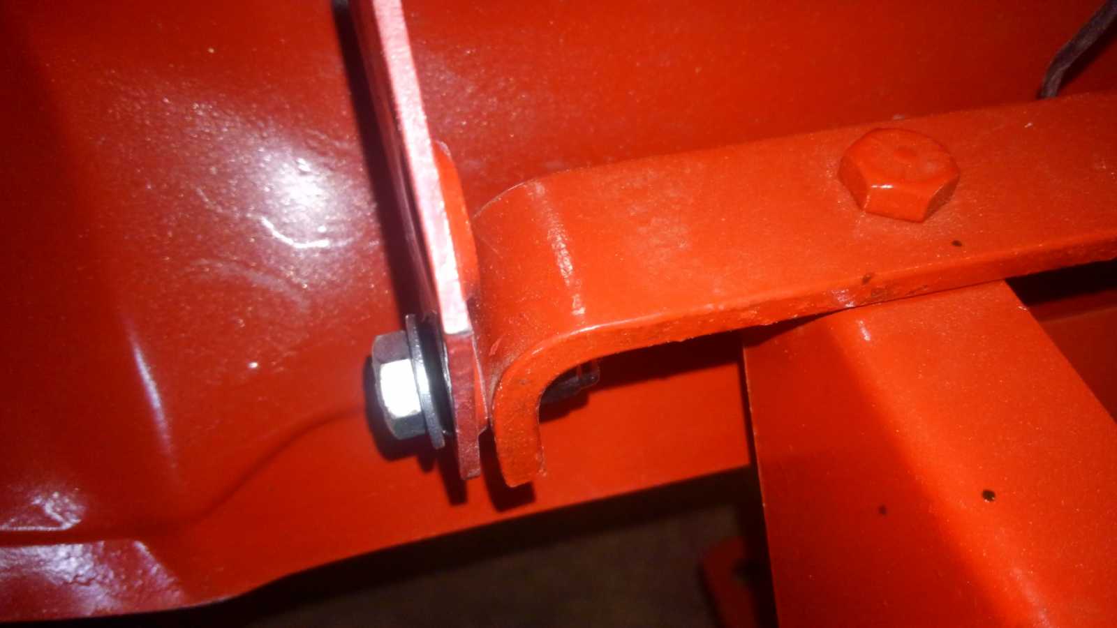

22 Dec 2020 21:49 #16563 by Rusty Tinsnips
Replied by Rusty Tinsnips on topic Wheel Horse 4937 Spacer

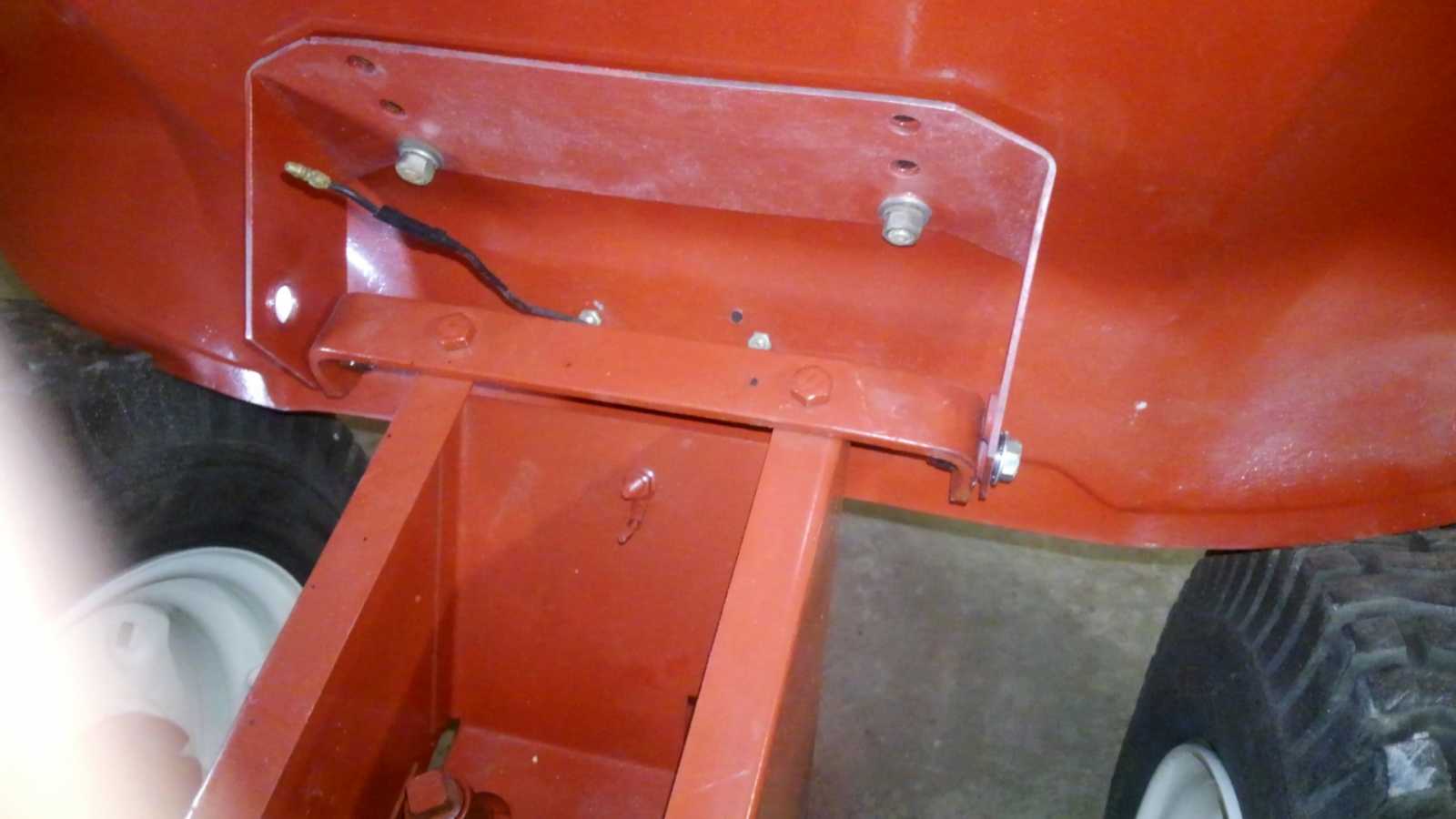

These came today and I got then installed, they fit perfect. Seat works better than new!
Thanks Gene for making my horse well again. You are awesome!

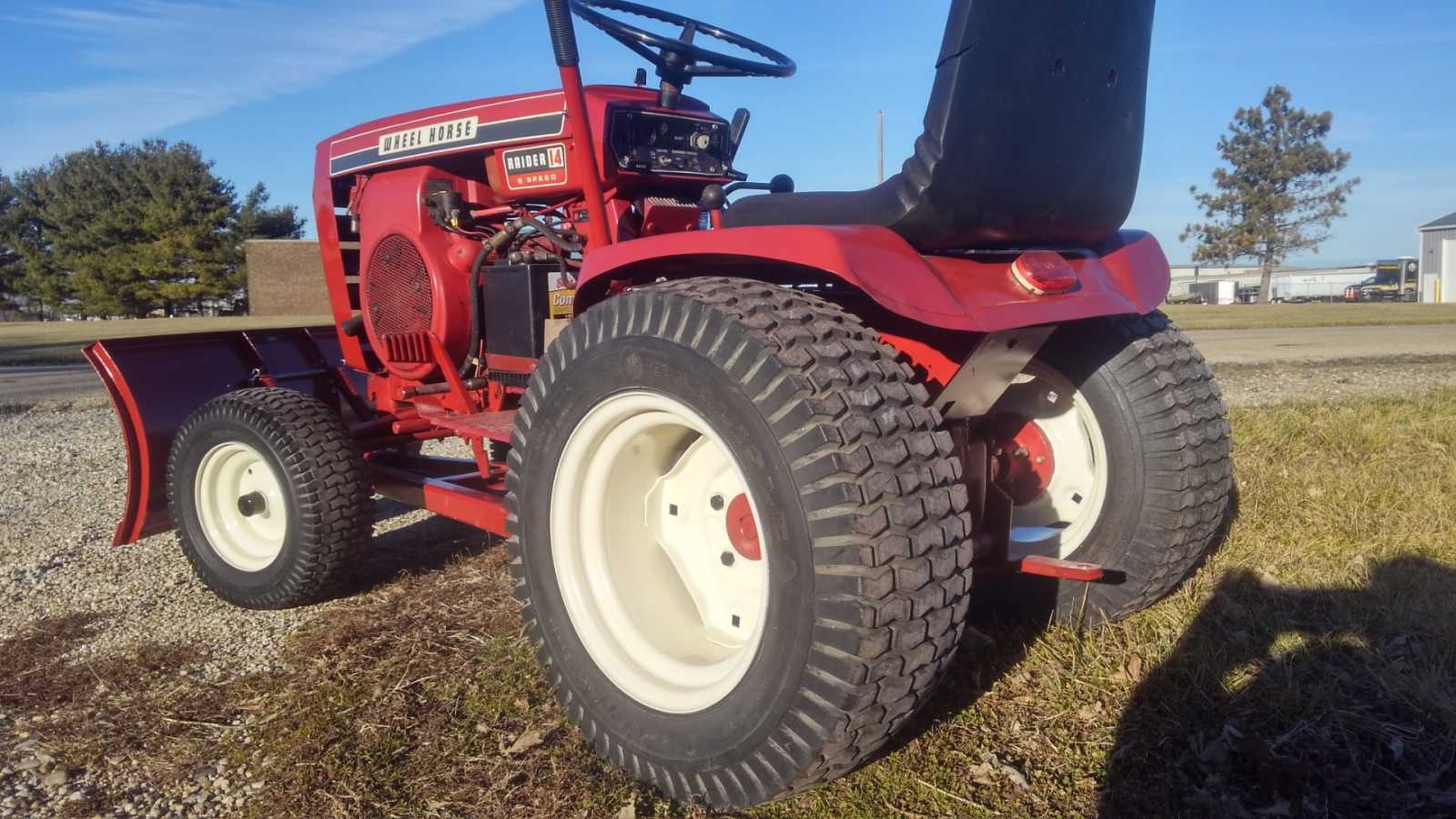

Thanks Mike and glad you got her fixed up. You did a really nice job on the restore, nice work. :goodjob
