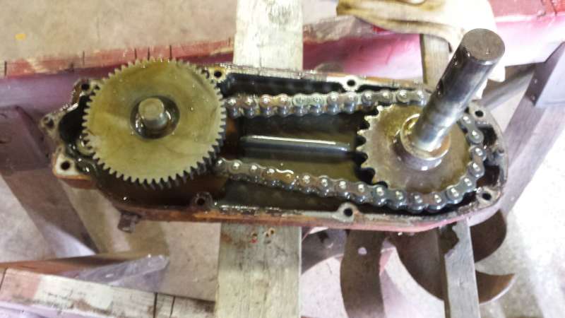

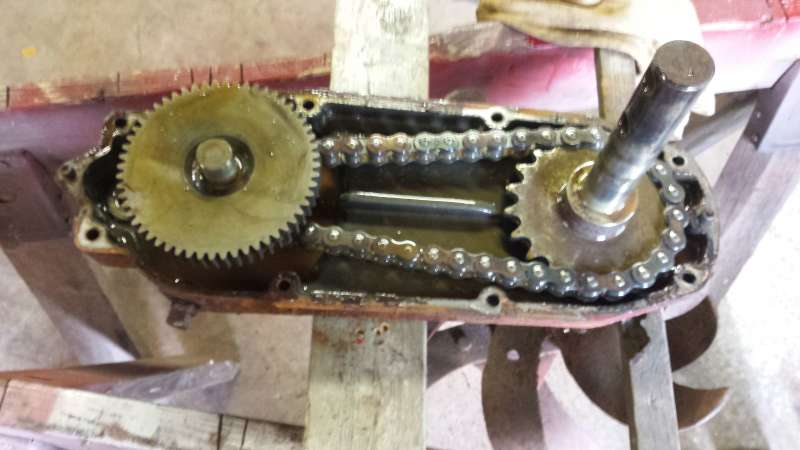

For those who may be looking inside a tiller.....

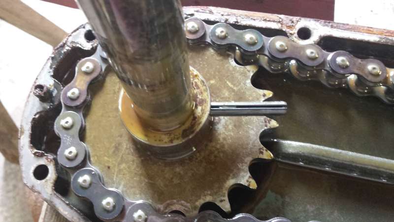

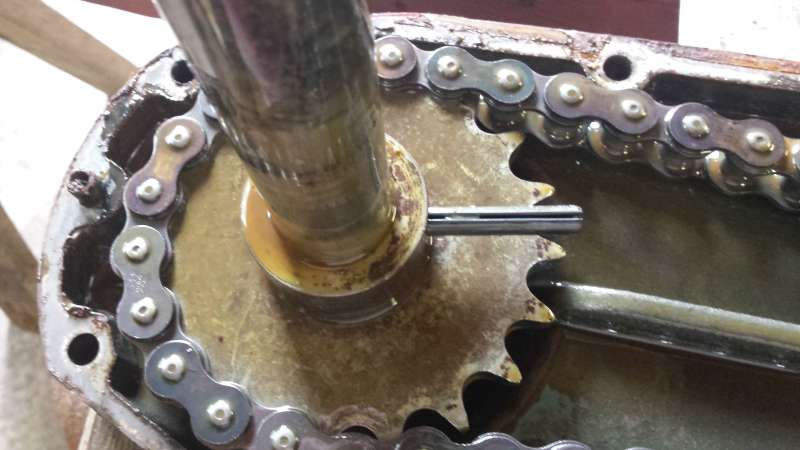

Looks pretty straight forward.....I needed to put some seals in....takes 2 each side for the main drive and 1 for the input.....

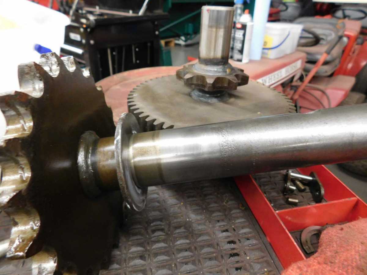

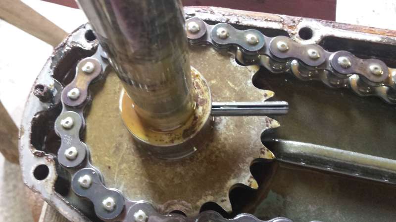

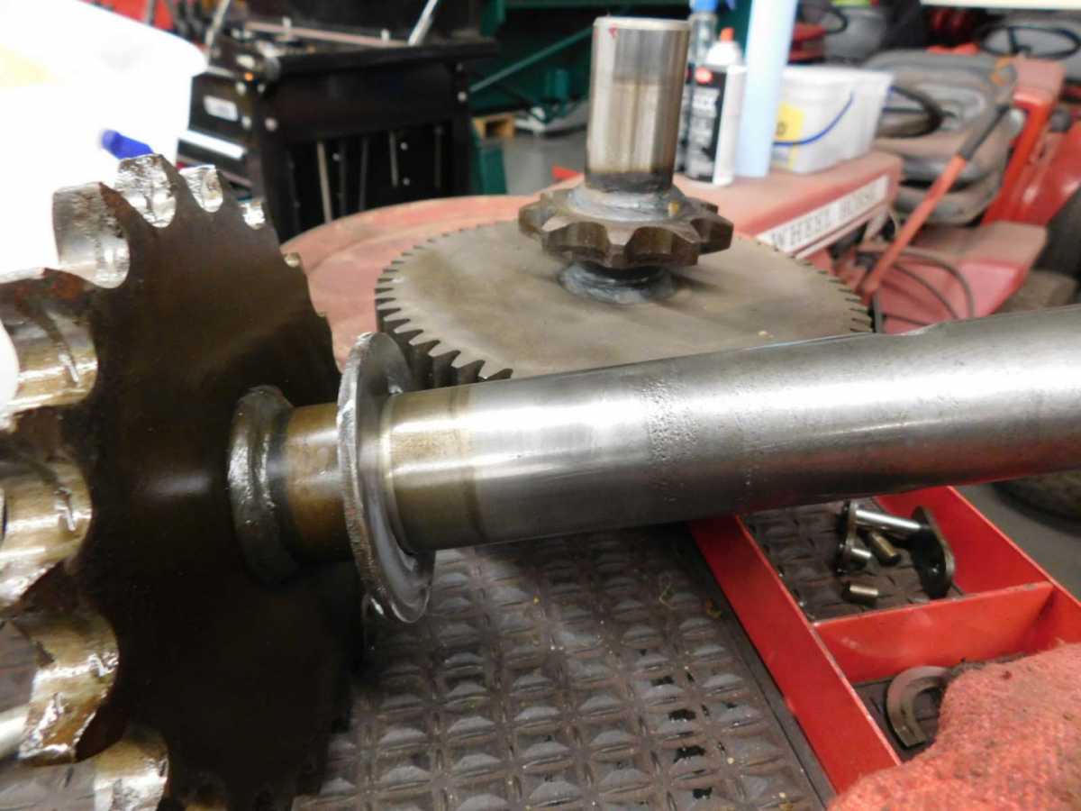

this collar is held in place by a pin....

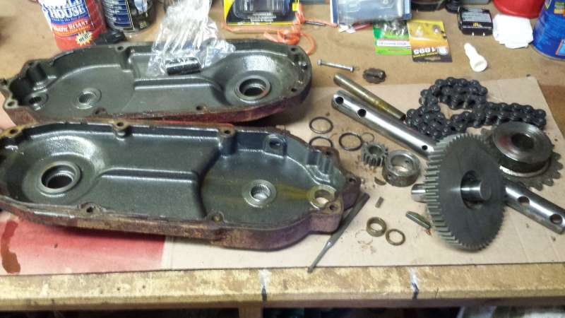

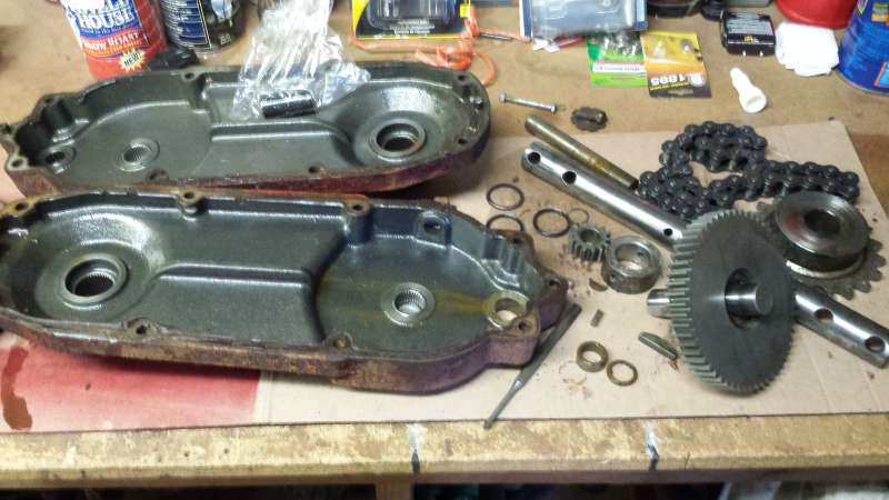

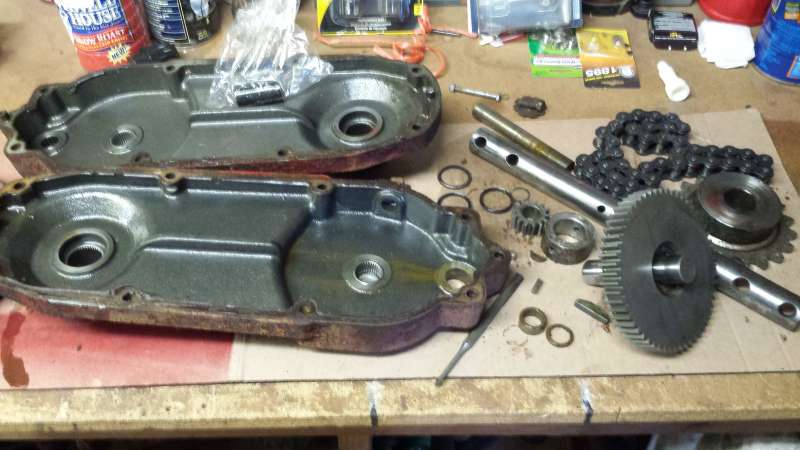

parts all laid out......
Seals are CR 12330 (4) and CR 7410 (1) I believe.....well pretty sure....at least that is what I have ordered....

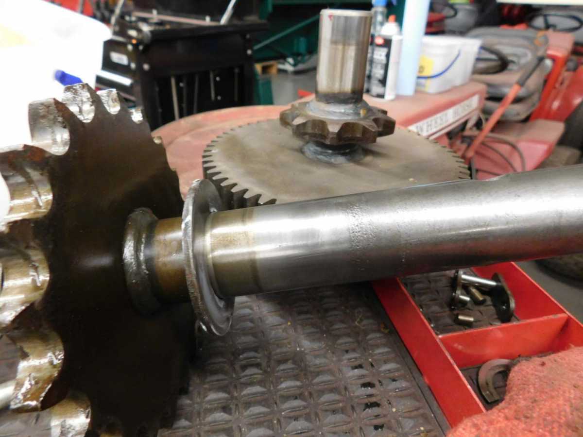

This tiller is a 07-36TL03, it was built from 1984-1989. The gears in this tiller are factory machine welded and don't come off.
It is 4-16-2016 and I am adding something to your post Bob.
