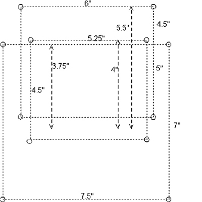

The seat only has one set of holes that fit....On the diagram I posted they are 4 1/2 back from the front and 11 1/2 back from the front....so look at the spring hole and measure 4 1/2 inches towards the steering wheel.....that will be the front of the seat. The seat you have may be the same. Just drill new holes in the spring......

The last seat I bought was one of these for my 416-8 from ASC
LINK
With this bolt pattern
Just over $50 shipped. Read the reviews.
